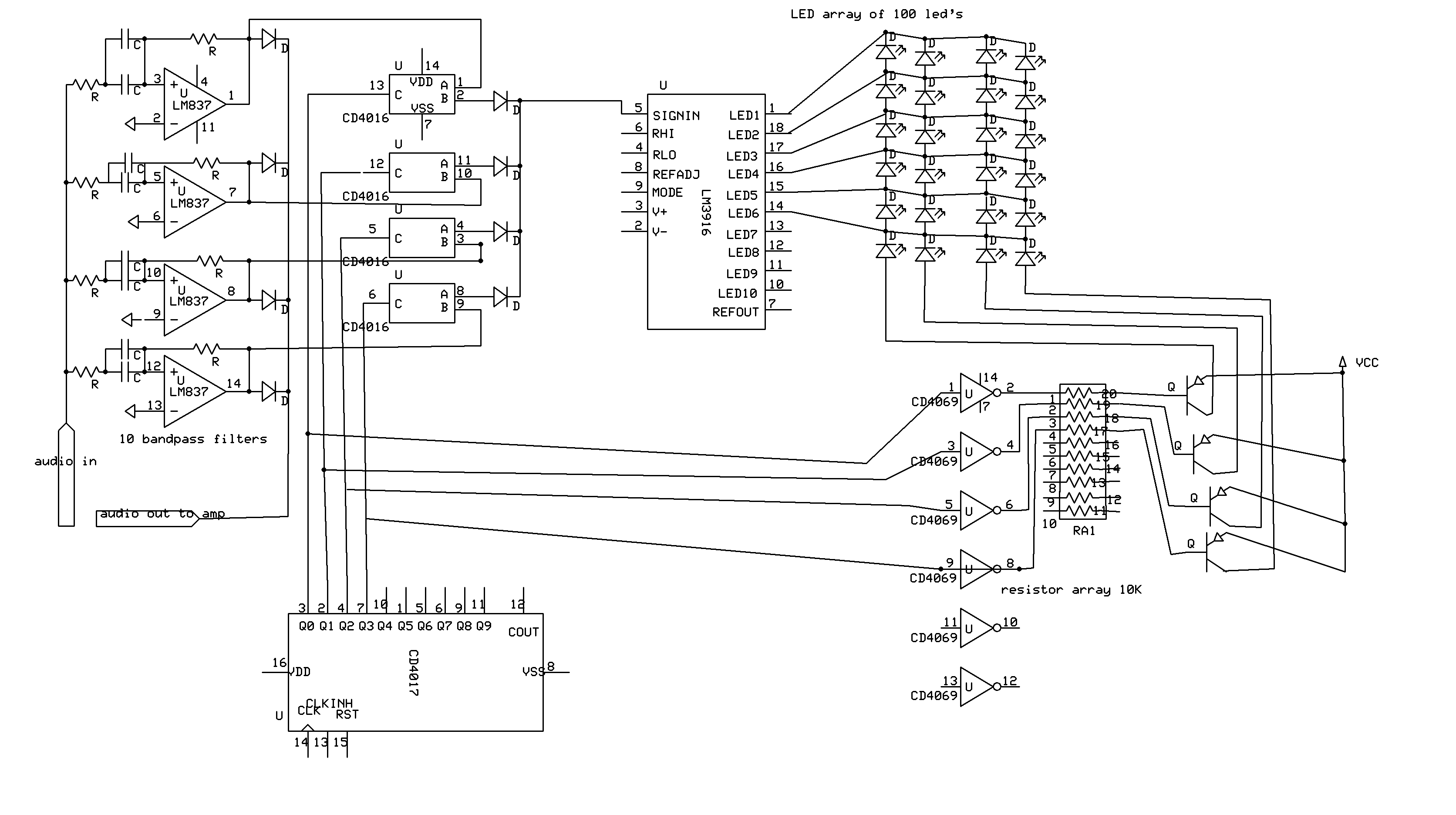

proposed design sch.
this is just starting. parts may not be oriented correctly.
need to clean up but idea may be better than a bunch of transistors etc.
may need diodes to isolate outputs of 4016 to 3916?
not sure if the 4017 will drive both the 3916 and the 2801?
any input?
transistors seem old fashion, low tech
circuit description of vu meter
In put from audio feeds the 10 band-pass filters - LM837’s
Outputs from filters feed the cd4016 quad bi lateral switches and are isolated from each other using diodes that feed the output to the amp.
The cd4016’s are cycled using the 4017 set up as a count to ten then recycle
The outputs from the cd4016’s feed the LM3916 dot/bar driver. The LM3916 outputs sink the X half of the 100 led array
The outputs of the cd4017 also cycle through the cd4069 inverters then turn on the transistors which control the Y half of the led array
In theory this should work??

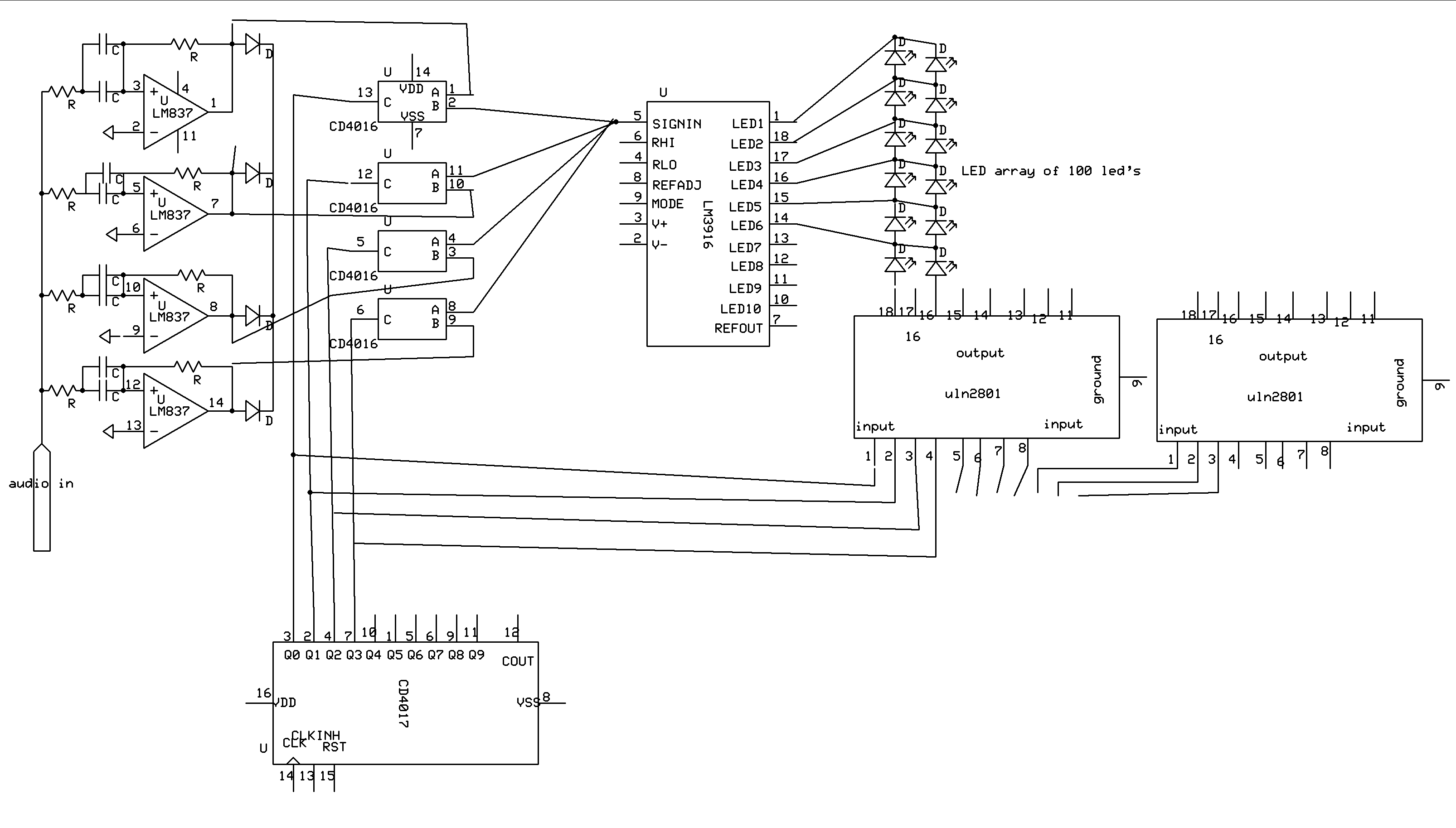

Your bandpass filters and the circuit in the article are wrong.
You seem to be shorting together most of the LEDs.

oups I see where I crossed up
the op amp inputs are backwards.
The LED array I drew is probally deceiving.
The leds are connected from the transistors to the outputs of the 3916 in an array type setup
one connected to the X and other end of LEDs to the Y
agfter looking at diagram I see what your talking about being shorted.
Thanks for the heads up
need to redra the array and switch the op amp inputs around.
I guess it was all the cutting, pasting then mirror the schematic.

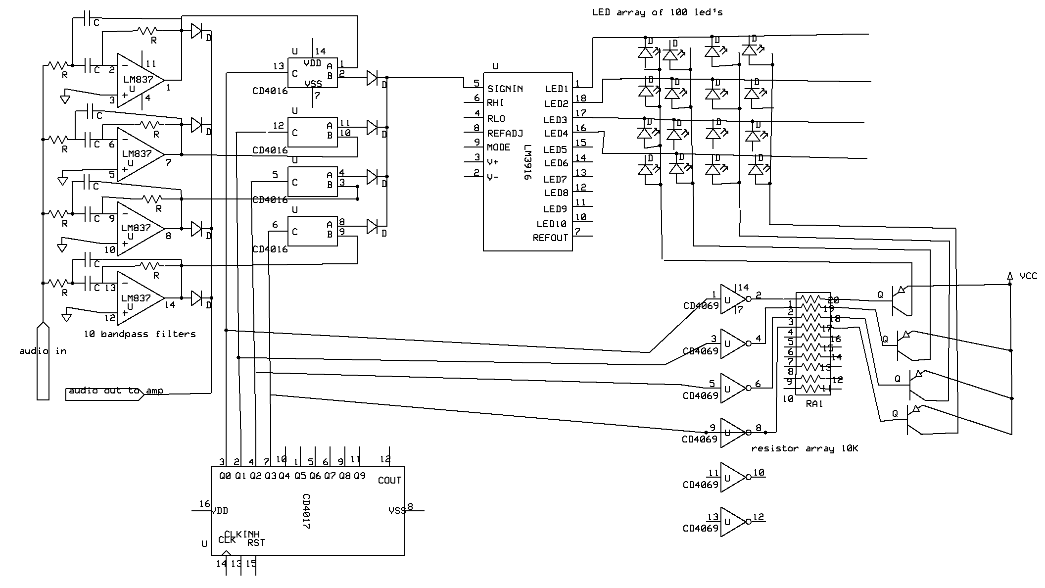

revised filters
I changed the inputs and re drew the led array
its basically the same circuit as
https://www.electro-tech-online.com/attachments/audio-spectrum-analyzer-en-pdf.15065/
this circuit calls for a C1815 but its a pnp transistor. I used the complement as stated in the data sheet. wish there was a better way?
the bi lateral switches I don't think would handle the current-need to look at that.
Was hoping to use say a 2803 or ? but the logic level is backwards.
