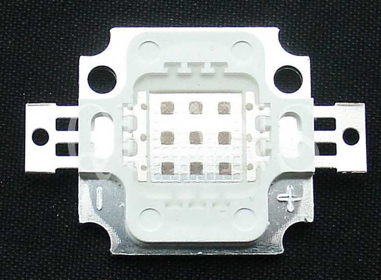

i recently purchased an LED kit that im putting in my aquarium that comes with :
10W 8:1 Red Blue LED
Driver
Heatsink
i am completely unsure on to wire the LED and run it either through mains power, or batteries, i have included some pictures:

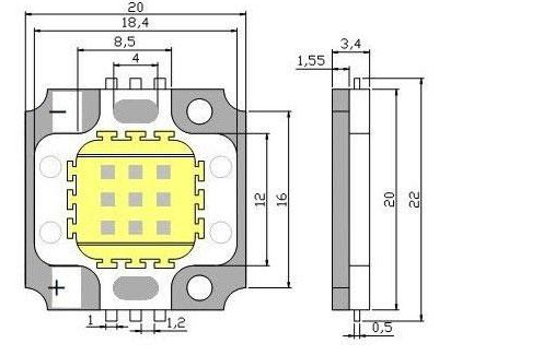

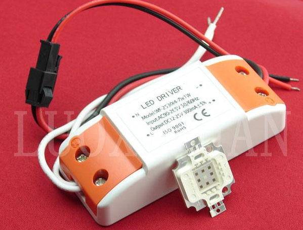

You have an LED driver with a regulated 300mA output and its polarity is shown.

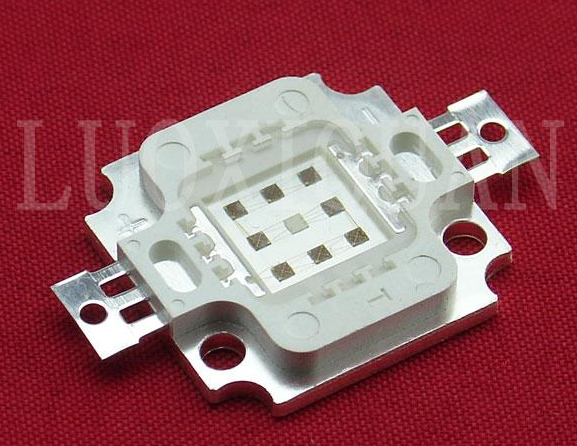

You have an LED module without polarity shown, no part number, no manufacturer's name and no spec's.
You are speaking in a unfamiliar languge haha, does this help? negative=left positive=right

You should notice that there is an L and N terminal on the LED Power supply. That connects to Line and Neutral. NZ's power is like 230 V 50 Hz, and the supply has a wide range 90-265 50/60 Hz. Those wires connect to the wall. L is usually the Hot wire and N is usually the one that is nearest the ground potential, For a two wire system, it doesn't usually matter except L would normally be switched. The 2 prong, type I plug would work. https://www.worldstandards.eu/electricity.htm#plugs_I Not sure if NZ has a split phase system. Split phase needs both power leads to be broken/contact made with the switch.

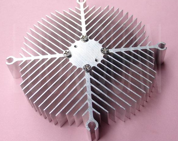

You should smear a little heat sink grease or thermal grease between the LED and the heatsink.
The LED power supply (PS) has a + and - on it and so does the LED. + of the PS to + of the LED and - of the PS to - of the LED.
ok thanks keepitsimplestupid! if you could tell me how to set it up as basic as possible i would be very greatful
Identify the + of the power supply
Identify the - of the power supply
Identify the - side of the LED
Identify the + side of the LED.

Here is a suggestion for the heat sink grease: **broken link removed** You place a light film between the LED and the heat sink before attaching.

Most of what the OP needs is really mechanical or electro/mechanical. So, there is putting the power supply in a box of some sort with two cables coming out of it. Some consideration MIGHT be placed on water resistance. No real need for a ground if the power supply is placed in a plastic box.
There are any number of options:
The simplest, I think is a cable gland for the power cable and a grommet for the LED output. Zip cord/speaker wire might be a good choice for the wire.
I think there was an installed connector pigtail for the lamp. Connection of a pigtail would normally involve solder splicing and covering with heat shrink tubing. A crimp style butt connector could be used and covered with heat shrink tubing. This stuff shrinks about 50% when heated. Crimping does require a tool.
The LED has to be mounted with heat shrink grease and also mechanically mounted and the heatsink has to be attached above the tank somehow. The wires from this assembly may need some sort of strain relief and/or disconnect. By strain relief, I mean something that will not allow the wires to tug on the LED itself. This might be as simple as some cable clamps and tywraps. Digikey is a place to get small quantities and not packages of 100. Tywraps should probably be black.
