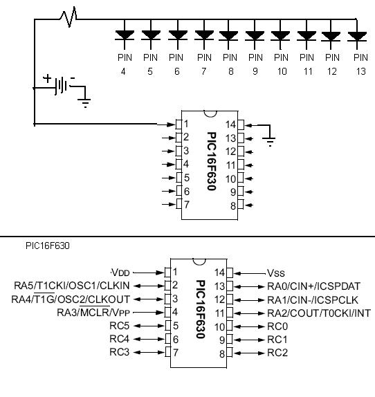

I am making a simple led binary clock. The first four LED are the hours in binary (read left to right). LEDS 6 through 10 are the minutes(read left to right) . I run an upload the code but minute LEDs seem to not work correctly. I am posting code and attaching schmatics. What am I doing wrong?
Thanks in advance
In your circuit diagram, you don't show any current limiting resisters. If you don't have any then this is probably your problem. Try placing some resistors (220R to 1K) between the output pins and the LEDs. Also, your most significant hours LED is on PortA,3 not PortA,4.
I changed that port number on the hour. I do have limiting resistors I just excluded them in the schematic. It still doesnt work.
I think you have your logic inverted.
As your LEDs are connected to 5V, then in order to illuminate them, you have to put a zero on your output pin. Your instruction clrf PORTA will turn all LEDs ON. I assume you want a zero to be OFF.

Can you show us a picture of how the LED's are to be arranged?
