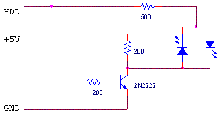

Two leds for PC

Thanks guys!
I used the top example, and it worked perfectly!
I am now in the process of finding a way of adding a switch to enable the green led, the one that runs from the 5v.
If there is a simple way to this, please tell me because I'm unsure where to place it in the circuit.
Thanks again, :D
well, all was well using 9V battery, until it ran out.
I decided the motherboard had constant power, tried to hook it up, started the PC, BANG, then dead.
I lost my hard drive and CD burner. Motherboard is fine though... :?
That was about 2 months ago, and all is fine now. A word of advice, use the power from the power supply, not from the motherboard. Now I am using the 5V red wire on the floppy power connector, and is working fine.
