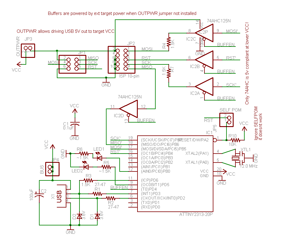

I ran into a little sag I don't have any 3.6 volts zener diodes and from what I read the USB data lines need a 3.6 voltage level I was thinking a have some white leds couldn't I use them to clamp the line to 3.6
yes it's possible. , a 5mm white LED looks like 3V Zener with 15Ω ESR with a Vth around 2.85V at high impedance, but not sure about 100 pF requirement.

I want change D1 and D2 to two leds

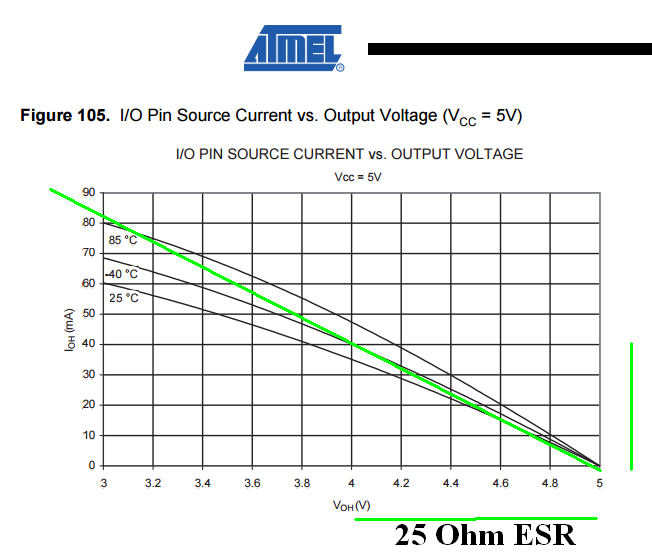

Include 50 load in your calculations.

Doesnt clearly state what vcc is, if its 3.3 then the leds would just be there for noise pickup filtering.
One thing about leds compared to zeners is capacitance, leds will be a little higher.

Given 2 conditions, connected with 50 Ω load and no load, the variation in Vo will be great.
May I suggest two AlGaAs Red in parallel reversed in series to provide a 2V drop from 5V and achieve Vo= 3V max with an ESR of 25+15=40Ω is a decent match and will reduce any risk of latchup from overvoltage on the interface with a 3.3V chip and 3.6V limit for interface.
No R's required, but not short cct proof. to 5V you can add 10Ω in series. but this is an unlikely fault.
Otherwise using your schematic it's hard to balance max current, max voltage and matched impedance with connected and disconnected cable.
I think I'll try the 3.3 volt zener diodes I have. Im not thinking the best these days could you kindly show me. I'm thinking just replace the zener with two leds there not much current on the data lines they just don't need to reach 5 from the attiny
You dont need 2 leds to replace one zener, just one, if you put the led forwards into the circuit, ie not reversed like a zener would be it should be fine, another thing with leds is that the reverse max voltage will be lower than a zener, however 5v shouldnt be enough to do them any harm.

Requirements are 20mA max in LED and 3.6V max into data + or - and 2.8V min
As long as these are satisfied it is OK.
With two 2V reversed LEDs current is 60mA so scrap that idea.
Optimal solution requires a series R1 from driver and series R2 to LED such that no connection load drive current is 20mA or 100 Ohm's total (minus 25R+15R = 60 Ohm's shared by R1& R2 ) with 2V drop allowing 0.4V drop on R2 to LED yields 0.4V/0.02A= 20 Ohms and 40 Ohms to driver R1, the. when connected Vo = 5V* (50/(50+40+25)= 2.17V which is low but may work.
Otherwise use a 1W LED with 1Ohm ESR and calc R1=> 50/(50+R1+25)*5V=2.8V then R1=29 ohms and I (no load )= 3V/54 ohms =56 mA
