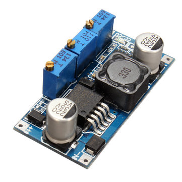

You will get a lot of variation in the battery voltage between full charge (over 20V) and near flat, around 16.5 - 17v.
The best option is a little buck regulator module, as Dandak suggested.
Get one with an output covering 12V and a current rating of 3A or more (as the listed ratings are usually the short-term just before failure ones, not continuous use).
This is a very common type available from numerous places; they seem to be pretty god, I've not had a problem with one so far:
LM2596 DC-DC Buck Converter Step Down Adjustable Power Supply Module -UK | eBay
(Load regulation: 0 0.5%. IN-IN + input Positive Input Negative. Could not boost). Output current 3A (max). Output ripple <30mV. Positive output OUT + OUT-output negative. Power Supplies. YOU MIGHT ALSO LIKEVIEW ALL OUR PRODUCTS.www.ebay.co.uk
Adjust the output voltage before connecting the LEDs.
it's designed for feeding LED's, and uses constant current.
Lighting units intended for a fixed 12V supply may not work well with a controller intended for bare LEDS?it would be nice to illuminate the control panel with some 12v strip lights I used under my kitchen cabinets,
The two regulators may fight each other or oscillate etc.
