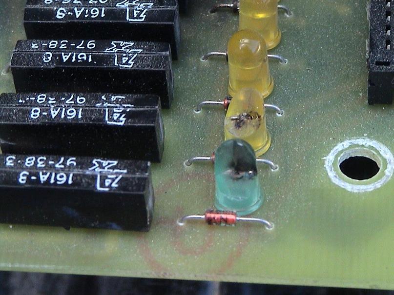

LED's blown up
Attached is a photo of two LED 's minus lenses which popped when lightning hit the parrallel to serial ports overhead cable on our cyclo plant in Warkworth during the storm.
The read switches next to it welded closed and the 1 N914's survived.
Ok surge diverters are in place which clamp the voltage to below 48 Volts but the LED's didn't like it.
OK a million or so volts does a bit of damage or so.:)
