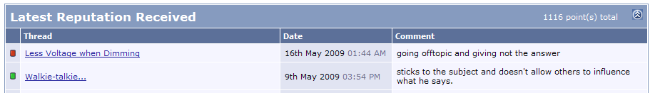

I was 99.99% sure it was you and going by the way you've responded I'm 100% sure.
It should have been obvious that I was trying to help you.
Please ask yourself this question before giving out negative reputation: "Is this person really being nasty?" If the answer is no then do not click on the negative reputation button!
I shall try to resolve this over PM.
SNG already got bad rep from me for their posts so far. There's no reason to ever respond in the manner he has so far.
Come on, stop talking about it and go on with posting about electronics.
Who cares about these reputation points... your knowledge and kindness is what counts and not some stupid reputation game... as a new poster to this forum I even don't know what that reputation thing does... and I even didn't know that clicking by that function it will cost Hero999 points....
if anyone has comments about this, please contact me in private, this kind of discussions don't belong in public... very simple forum ethics.... this is also what I wrote in a posting before but deleted by myself to get this absurd discussion stopped!!
