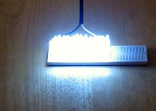

Woke up early and had some time to kill, never did anything with mains before so I whipped this up for amusement. Also goes to show what having a large bag of idle 15000mcd LED's will do to a bored person.
Two sets of 40 LED's in series, one wired in inverse parallel. The flickers a bit much (at least for me) but it's served it's purpose of amusement, and that first thrill of plugging something into a wall without it bursting into flames.
Tell me you used a resistor also. :eek:
kchristie, there was no need for one. The voltage drop is 124 volts, slightly more than the RMS voltage of the outlet, I calculated the RMS current was going to be 8ma's (this is a linear asumition I'm not sure how the diode no linearity will tweak the RMS ma's). I bought them as a lot so I'm asuming they're closely matched. Even the worst case scenario of the 170 volts across them that's only 4.25 volts per diode, it's a bit high but the peak is so short it's not hurting anything.
From what I gather LED rope light uses a setup very similar to this. I actually used more LED's than I needed just to be sure I didn't burn them out.

I normally use series resistors with LEDs, the worst I've ever done is connected up three 350mA LEDs in series to a 9V.
As I said, the RMS voltage for the diode array was covered plus 4 volts. Diodes are forgiving devices, and in reality it's the junction temperature that is the true limiting factor. The peak inverse was covered less transients and surges. No resistor was needed. For real world applications the wire resistence, capacitive and inductive reactance would have regulated the maxium current well bellow the failure mode of this particular diode 'structure' Otherwise they wouldn't use them in LED rope lighting, mind you they're cuttable at every half phase voltage level (couple feet usually)
