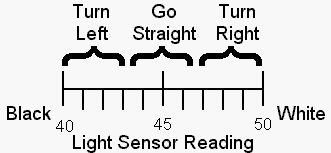

I am working on Line follower robot with two sensor connected with variable 20K making voltage divider. directly to ADC input ...it is working fine..
i want to add PID for gaining more speed and control...
so, this link tutorial for one sensors..
how to set offset and other const parameters?
Kp = 10                               ! Initialize our three variables
offset = 45
Tp = 50
Loop forever
   LightValue = read light sensor     ! what is the current light reading?
   error = LightValue - offset        ! calculate the error by subtracting the offset
   Turn = Kp * error                  ! the "P term", how much we want to change the motors' power
   powerA = Tp + Turn                 ! the power level for the A motor
   powerC = Tp - Turn                 ! the power level for the C motor
   MOTOR A direction=forward power=powerA ! issue the command with the new power level in a MOTOR block
   MOTOR C direction=forward power=powerC ! same for the other motor but using the other power level
end loop forever                      ! done with this loop, go back to the beginning and do it again

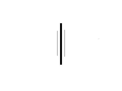

In the above most link he is using one sensors....i.e. offset 45
but i am using 2 sensors with black line on white the voltage is 0..2 to 0.5 and for black it is more than 2.8V (ranges is 0 to 5V) so, how should i calculate offset or just reading on black line?
That is something that you just need to figure out yourself. Test, take measurements.. Nobody can tell you what your sensor reading will be from half way around the world. Buy a good test equipment and measure things! You can get an analog oscilloscope for 50 USD and then there is the PicKit (with 3-channel logic analyzer).. buy it!
