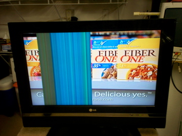

Have Lg ru-23lz21 lcd After hot gets horizontal bars in picture from top to bottom. Anybody out there seen this before? Picture included Thanx TvJoe.

Dead panel. Column driver or two is damaged (ask me how I know :eek:). AFAIK that's not fixable other than getting a replacement panel.

Nigel thanx for info. Will keep it in mind. Changing from broken panel. But being 23" not worth repair. Thanx again TvJoe.
