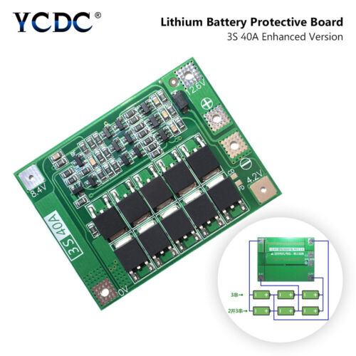

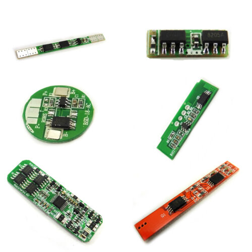

Rob, I was about to order a few BMS boards and noticed they don't have cell balancing.
So I assume they must be avoided ?
Oops... Well spotted, I normally only use high current ones - it makes no difference with the battery function, just use a series fuse or polyswitch etc. for lower current applications.
This is the type I normally use for three cell packs:
