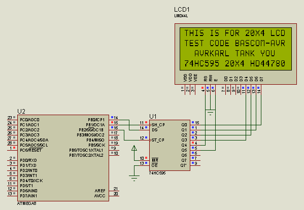

Hi everybody,
I need Library 3-wire serial lcd using 74hc595 for CodevisionAvr
Please guide me
You can copy the lcd.h and the lcd.c library into Your project folder.
Change the include in Your main routine.
Then You should change the parallel output routine into a serial Output for the 74HC595 in the copied files.
So You can use this library for the serial LCD.
