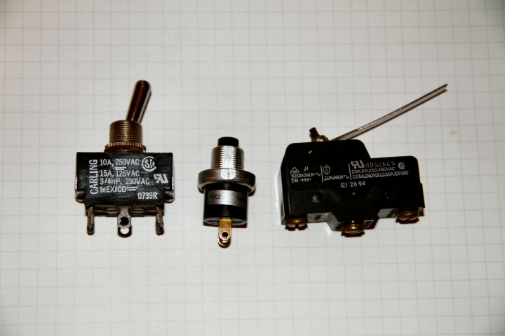

Among the parts you mention are relays and switches both of which can be mechanical devices. Depending on the number of cycles of operation these devices should have an average failure rate based on cycles of operation. That information should be contained in the manufactures data sheets.
For example attached are some switch images. Note the image of the lever actuated micro-switch. Read this data sheet on a basic micro-switch. Suddenly a simple switch becomes a complex affair doesn't it?
Check the data sheets on the capacitors and see how they are derated at higher temperatures and voltages. The list goes on and on. Then once I have my parts and build the product I need to test it as was well covered to make sure it meets or exceeds what I say it will do.
