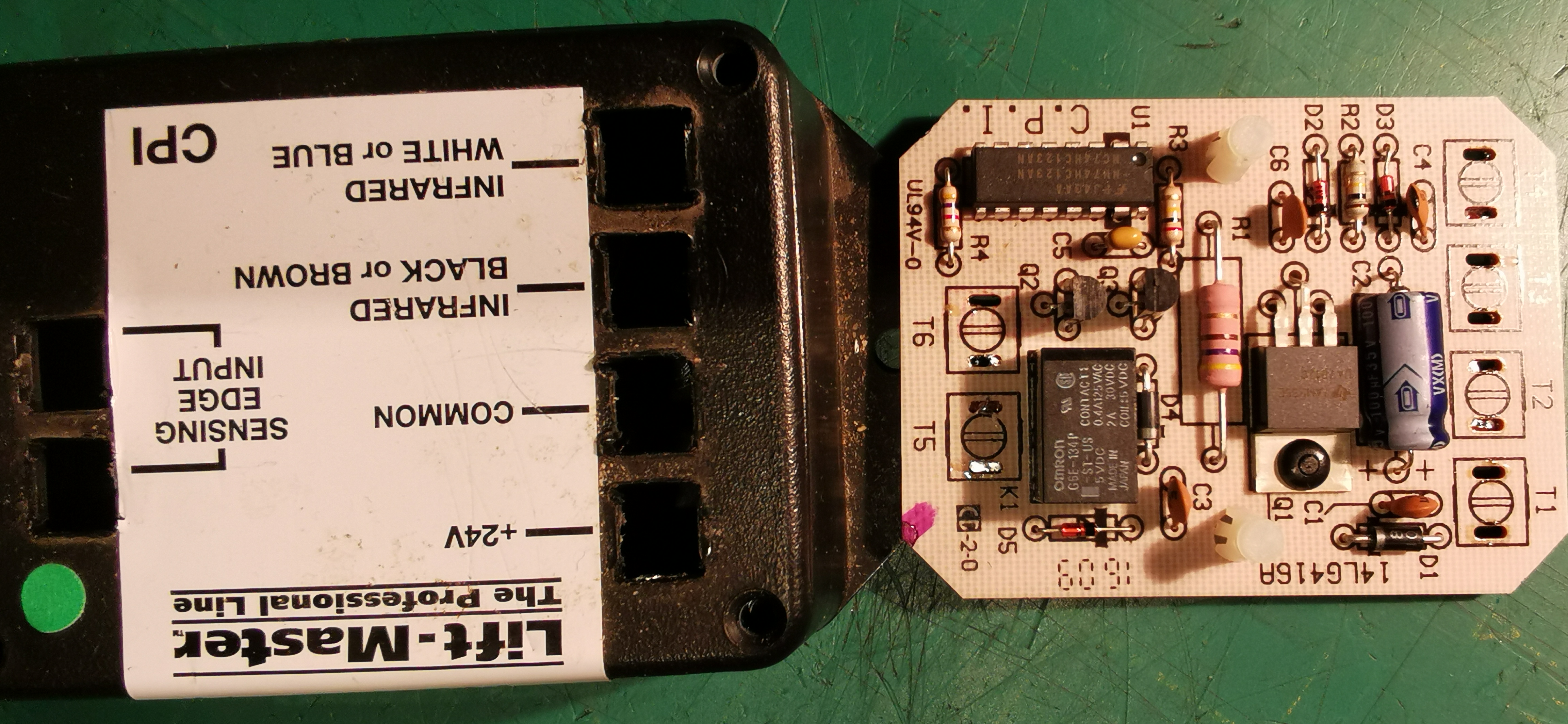

Does anyone know which resistor or other electronic component goes bad on a Liftmaster CPS-EI Interface module?
I am trying to pin point which component to replace and cant seem to locate the faulty resistor

The faulty CPS-EI unit causes door to reverse and go all the way up. With the unit disconnected, all the functions of the door work perfectly except for there is no sensor reversing function. I purchased and installed new interface and everything works perfectly. Being that this is the 2nd time around for replacing this in a few years, it would be nice to know what is actually causing these to fail, and maybe try to address the issue.

Often what's missing in commercial products is adequate surge suppression. e.g. transorbs

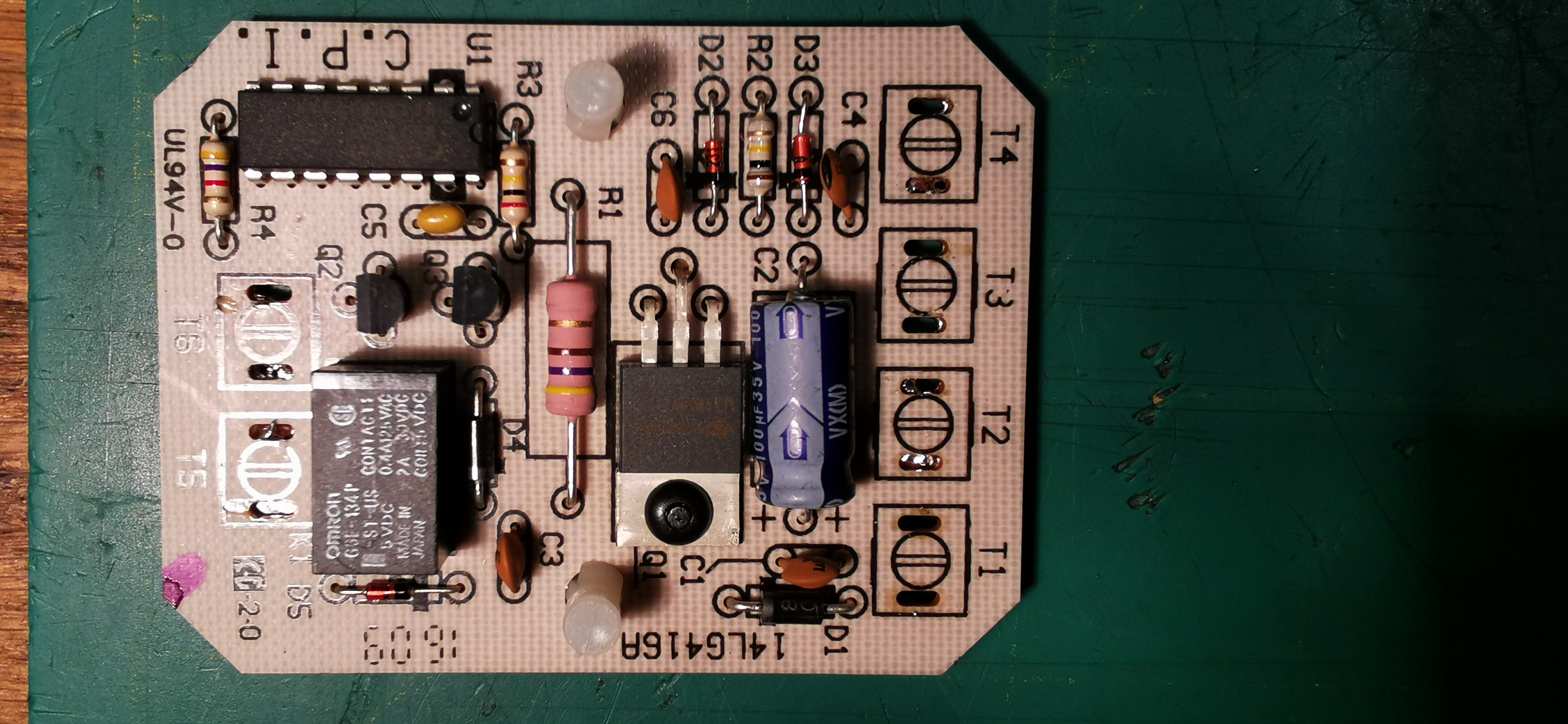

The first few things I see, is no heatsink on the regulator. The second is the HC https://assets.nexperia.com/documents/data-sheet/74HC_HCT123.pdf part has a maximum voltage of 6V and a 12V regulator. I'd check what the supply pins are seeing.
one possibility is that the designer thought that HC logic family uses the higher voltages of the CD4000 family.
The heatsink is still important because it allows the regulator to shut down.
So, that's my guess as the bad part. (the 74HC123)

I'd look for the presence or lack of bypass capacitors on the regulator.
The large filter capacitor can be an issue.
Look at the voltage on the 74HC power pins? it must not be greater than 6.

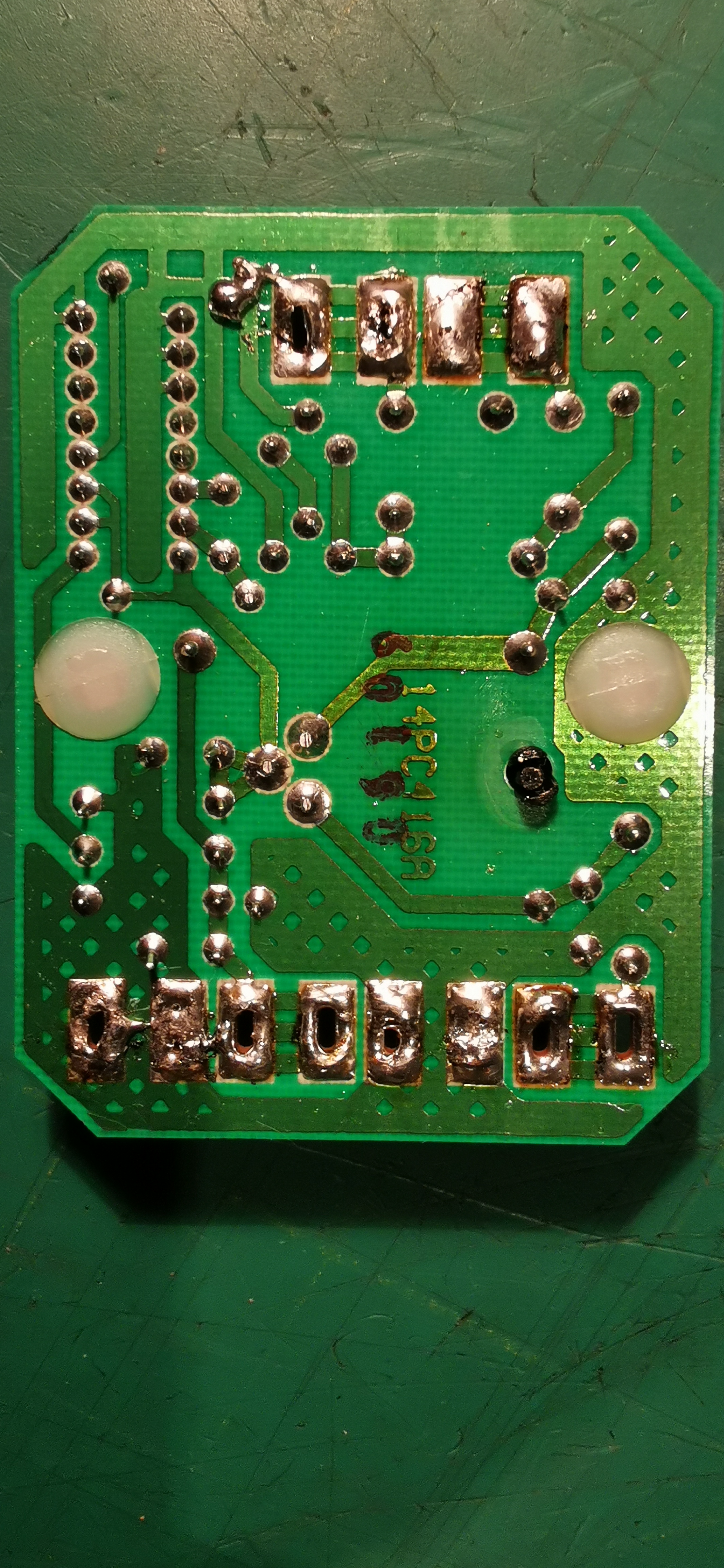

A photo of the back of the board would be useful. None of the components on that are complicated or expensive, so repair should be possible.

I think Driver300 is thinking along the right lines. I suspect the IR beam unit sends a string of pulses to the board when the beam is NOT broken. (This is the way my Chamberlain door works.) As the IC is a dual retriggerable monostabe I think it is configured as a missing pulse detector. If you trace out the schematic of the board we will probably be able to suggest how to trace the fault on the board. It is just possible that the IR beam unit is sending out pulses at a frequency that is just on the threshold of the missing pulse detector. (Slightly too low a frequency.) Do you have an oscilloscope to check the pulses though the board ?
If the fault is time-related it could be the capacitor, but that is just based on the fact that electrolytic capacitors degrade with age.

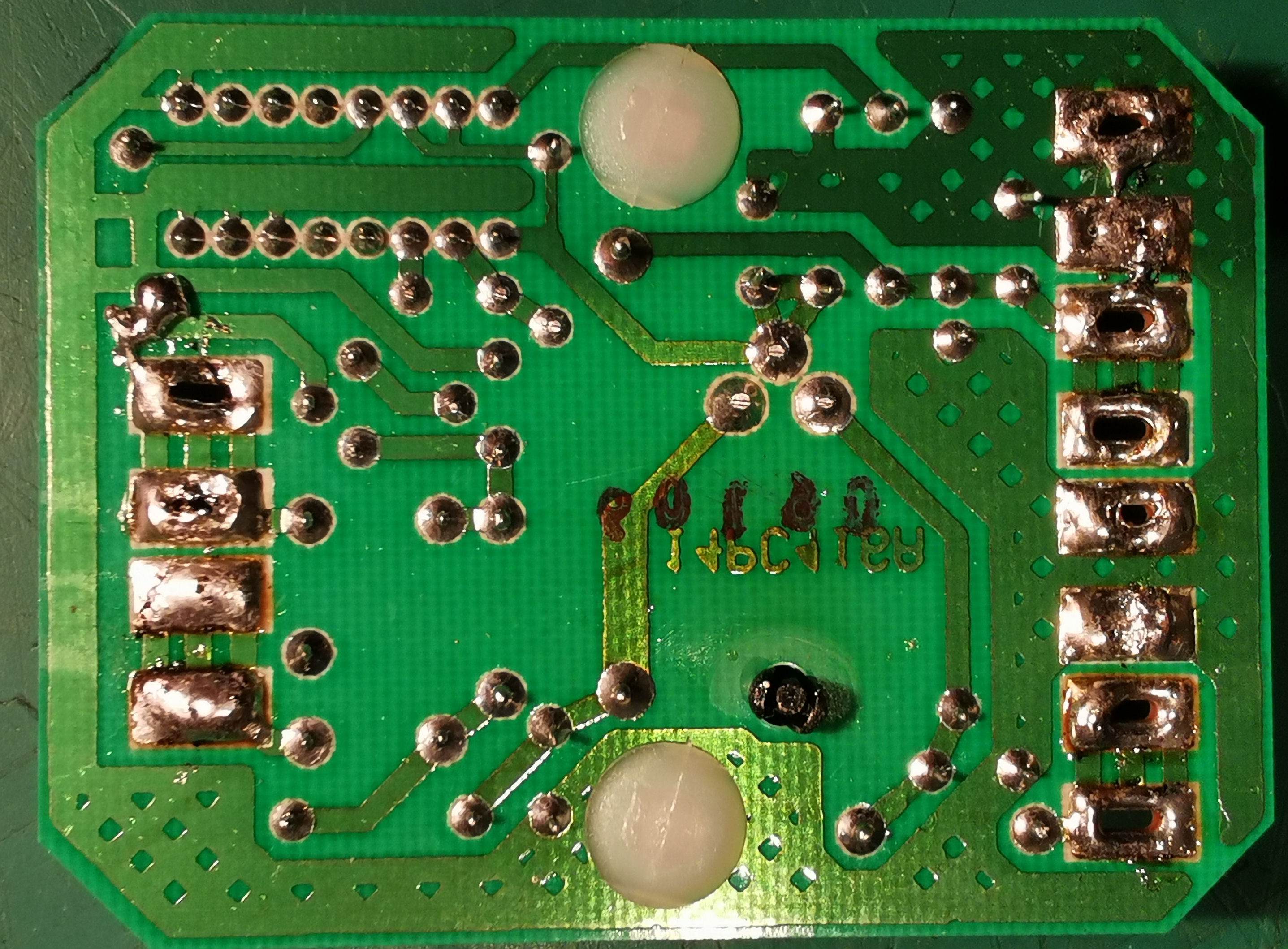

Disregard the left-over soldier globs from removing the screw terminal connectors in order to access the board.

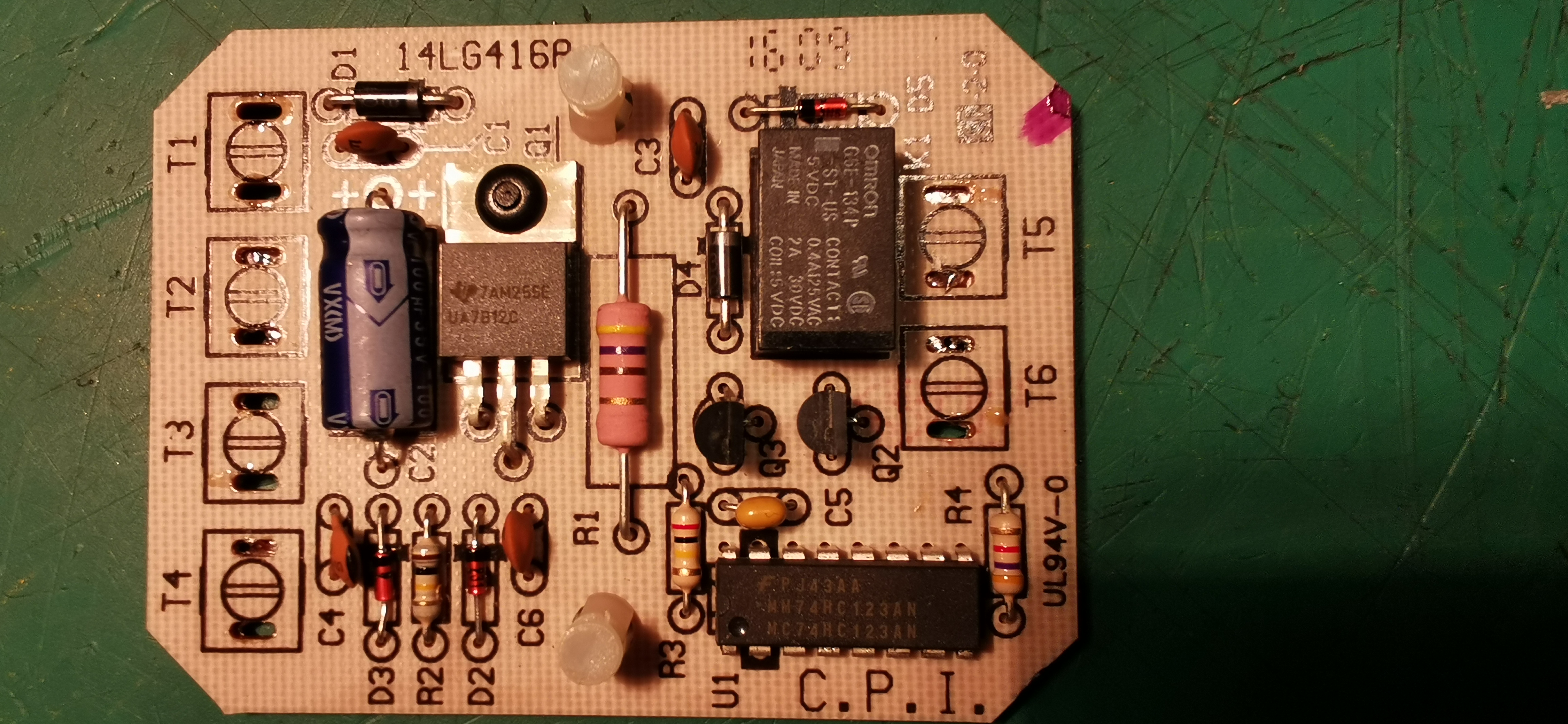

I originally thought that the TO220 device was a voltage regulator (LM78xx series or an LM317) But the way it is connected does not fit. What is the part number of the TO220 device ?.
I have uploaded a rotated and mirrored picture of the etch side to make tracing the schematic easier. Can you describe how the edge detector works or post pictures of it so we can try to understand how it works ?

The common connection of the 7812 is connected via D2 to ground. I assume that D2 is a 5 V zener, as Vcc (pin16) of the IC is also connected to that.
That makes the output of the 7812 to be about 17 V, which powers the big resistor as a current source to the sensor.
The 5 V relay is supplied via D5, so I guess that is about an 11 V zener to drop the voltage to the relay to give about 6 V. The IC drives the relay via Q2 and Q3 connected as a darlington pair, so there'll be about 1 V drop there, leaving 5 V to run the relay.
R1 provides around 30 mA to the sensor. D3 limits the voltage on the sensor, and C4 will reduce the effect of noise.
When the sensor activates, the voltage on the sensor wire goes low. That is connected via R2 to pin 1 of the IC. Pin 1 is the not-A input, and when that goes low, the output, pin 12, goes low for a short time. Pin 12 is connected via R4, Q2 and Q3 so when the pin 12 is high, the relay is on.
I think that in normal running, there are continuous pulses from the sensor, so pin 12 is always low. When the pulses stop, the pin 12 of the IC goes high and the relay operates.
When the relay operates, it connects T5 to T6, the ones labelled "sensing edge input". I guess that reverses the motor. I don't think that the relay can operate for long times, because D5 would get quite hot if it were run for a long time.
Hi Diver300, I agree with your conclusion. I had assumed at first that T5 and T6 were inputs to the board but they are outputs, The two wire IR beam brake circuit seems to be the standard way that the transmitter and receiver are connected. (The TX and RX units are connected in parallel.) I don't understand why they used a relay with a 5 volt coil which required D5 (Which must be a zener diode.) to drop the voltage from 17 volts to 5 volts. I think if the OP does not have an oscilloscope and pulse generator the best he can do is DC voltage checks and check for collector emitter shorts on Q2 and Q3.. (They seem to be in a darlington configuration..)
