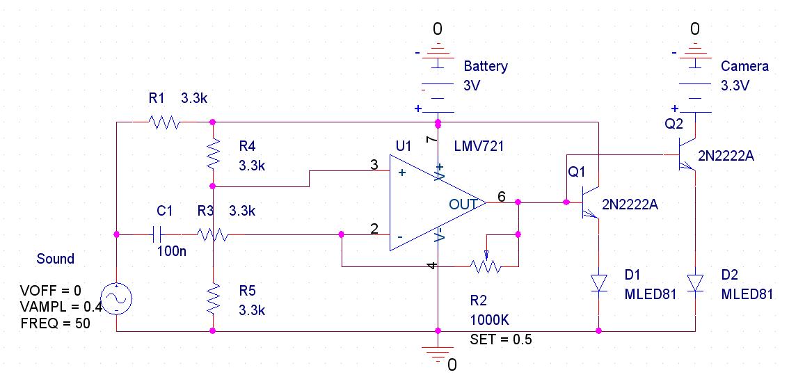

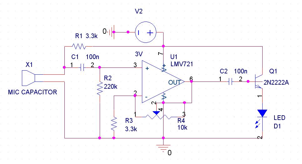

Hello,
I need some help to create two sensors using LMV 721/722 OpAmp
One will be a light/dark activated switch for one led and the other a sound activated switch. Both must have sensitivity adjustment.
The light circuit I've manage to get it work only for the switch part (switching the In+ and In- of the op amp), the sensitivity one..no luck:(, as for the sound sensor nothing till now (the microphone is a capacitor one).
The supply will be a 3V Li battery.
Can any one please help me to solve these circuits?
Thank you.

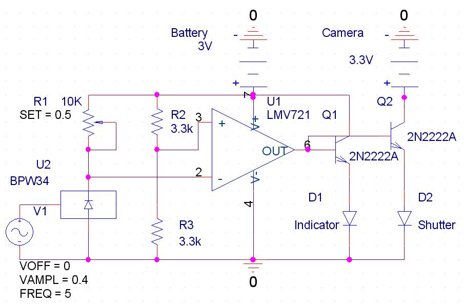

What LED will you get which you can light with emitter follower from 3V?
BPW34 generates what is better considered a current. The divider R1/R2/R3 makes no sense.
C2 blocks the return of base current on Q1.
Gain of 3 is not enough.

I increase the value of R4 to get more gain and remove C2...no success
"The divider R1/R2/R3 makes no sense" i don't know what do you mean by that...sorry, i don't want to be rude, but i am a new in electronics.

"The divider R1/R2/R3 makes no sense" because there would normally be a voltage source at the top of R2. If the top of R1 is also connected to a voltage source, then it would seem to me that the diode U1 is backwards. (Incidentally, BPW34 has only two terminals, not three, in the data sheet that I find).
What do you thing about this one?
in order to simulate the circuit, the third pin of the photodiode represent the excitation source
PS How can i attach more pictures to this post?
the pictures are here
I want to build a camera shutter trigger with a light and sound sensor.
When the microphone detects a sound the shutter is on. I need to adjust the sensitivity to not have false triggers. To see the threshold that triggers my camera i need the led (actually there will be one more transistor -same base as first one - that closes the camera trigger circuit)
For the light sensor i need two modes:
1. Trigger at lighting or other flashes (sudden light increase)
2. To trigger when a beam of light that falls on the photo diode is interrupted (to get nice pictures of water drops).
This is what i want to achieve.
Instead of photo diode i an use a photo transistor, but it has slower response and I've read that for this type of application BPW will do a better job.

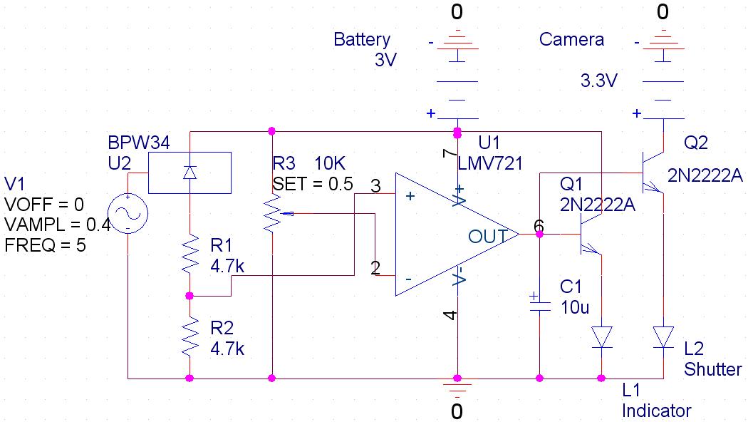

Hello,
I think I've made some progress here and i need your opinion
What I'm not able to do is to change the circuits sensitivity so i need some advices.
One more thing, do you think it is possible to increase the time of led (D1,D2) being lit without using a 555? If yes, how can i do it?
Thank you

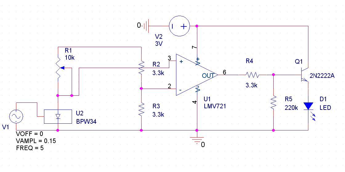

I think i get the sensitivity part working (not sure at all) on the light sensor but for the sound I've got nothing.
Please, it must be somebody out there who is willing to help me solve these problems
PS: I found somthing similar but it uses a micro-controller, maybe it will give you an idea https://www.doc-diy.net/photo/smatrig/
