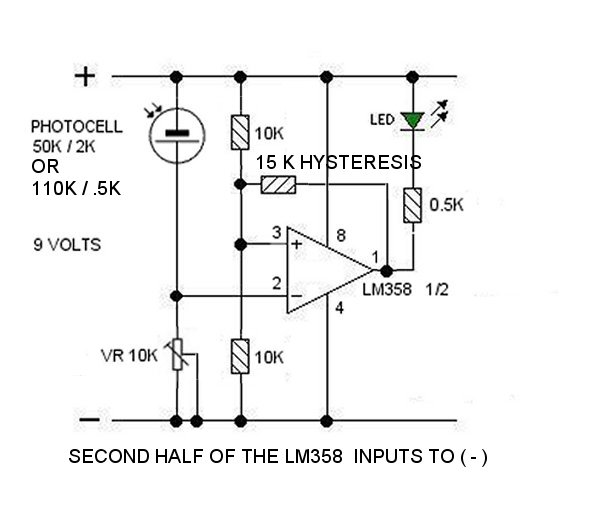

Hopefully I have managed to attach a circuit given to me.
Problem is- I think- that the LDR in the circuit is about 10 ohms [light] and 25k [dark]
All I can get hold of is [typically] 10k [light] and 0.1M [dark]
So I reckon that components need jiggering.
ANY help would be welcome.
Try changing the pot from 2k5 to 100k.
The circuit shown will trigger the 555 when the LDR goes dark. If you want triggering to occur when the LDR goes light just swap the LDR and pot positions.
Most LDRs have dark resistance in the 100M ohm region. 100K sounds more like twilight, not pitch black dark.

If you don't mind using a LM358 here is a circuit that I found on the net a few years ago.
And the application I made with it.

That is not a good schematic,w LDR connecting to pin 2. I have a better and simpler using 555. I will post it tomorrow.
Gajanan Phadte
For a not good schematic, it is working pretty darn well!

Guys, I am no nearer a solution to my original question. Which was- can anyone spec. a LDR and suggest alterations to my scheme that would be needed to employ that device.
Just for the record- I intend to use it to switch an electric fence energiser off during daylight hours. I only want to scare the foxes and not the grand kids! HV is provided with a 12v motor bike coil. The energiser is pulling 20ma in pause and 50ma under pulse conditions.

The solution that I posted answered all your questions. It is adjustable and would probably work nicely for your project.
I just tested 2 LDR that I have and they are both working with this circuit.
The first one is going from 130 Ohms under my fluorescent lamp to 130K under my desk and the other one is going from 250 Ohms to 800K
The schematic circuit will give the action that you need, that is ON at night. Just change the LED resistor if you use it at 12 volts. The breadboard circuit gives the opposite. Pin 2 and 3 are swapped.

Bonjore (Sorry, my French is terrible),
1) It is a fuzzy JPG file type instead of a very clear GIF or PNG file type.
2) It shows a solar cell connected backwards, not a light-dependent-resistor.
3) The resistor values for the opamp inputs are much too low.
4) It does not have an important supply bypass capacitor to keep the battery voltage from jumping all over the place.

Look at the datasheet for the LM358 dual opamp. Its input bias current is typically almost nothing and its entire supply current is about as much as the two 10k input bias resistors. So the two 10k resistors can be 100k each.
The 10k variable resistor can be 100k for 10 times the sensitivity and the 15k hysteresis resistor can be 150k.
