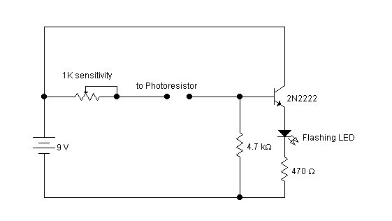

We keep forgetting turning off the lights in the basement. I would like to install a sensor to detect when a lamp is on in any of the zones, and if so, trigger a circuit that will activate a blinking LED located upstairs, somewhere in the kitchen. When a lamp is on, the circuit should flash an LED at a rate slow enough to be noticed by someone in the kitchen, but not so fast that becomes a distraction or annoyance.
The basement is 30ft x 24ft divided in 4 equally sized quadrants. Each quadrant ceiling has a 4-ft fluorescent lamp, but there are also some table lamps with incandescent bulbs.
There are windows in each zone that bring in a good amount of light during the day. Therefore, the circuit shouldn't go off under natural light conditions.
Is anyone aware of a reasonably priced commercial product to do this job? If not, can anyone point me to a circuit that I can build?

take four components, a light sensitive resisistor(cds cell?) and a potentio meter of about the equal resistance, and a transistor, and a blinking led, and hook the two resistors to the base and the led at the collector, or emitter depending upon what kind of transistor you use and adjust the sensitivity with the potentiometer. Oh yeah, you probably need a resistor to limit the current going to the led too.
From another view, the job of isolating the photoresistor from daylight will have to be your invention.

Thanks for all the replies above. The diagram is specially useful since I can identify the exact parts and how to put them together. (I am not capable of translating textual description into a diagram.)

After considering the various ideas, I think that I want to pursue building the circuit that Gene posted on Sunday. It gives me a chance to learn a little about electronics, and expand from there.
A couple of questions:
a. Will this circuit be able to work with four photoresistors in parallel to cover the four quadrants?
b. Or should I build a separate circuit for each basement quadrant?
In any case
a. what is the longest wire run that I can have to/from the photoresistors?
b. what is the longest wire run that I can have for the LED (if I locate the LED remotely from the rest of the circuit)?
