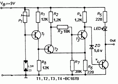

Hi 4electros :)
I suggest this diagram
It’s accurate, simple and practical
Or you need to design one using Op-Amp as comparator which works on the same principle.
