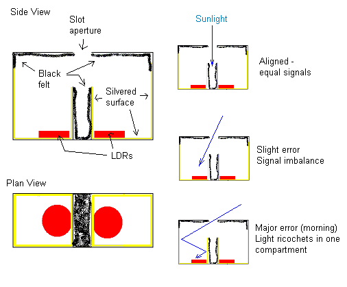

Tracking the Sun
Would something like this work :?: (attached drawing)
If a small rectangular box was constructed as below...
a central compartment aligned with a slot in the lid will catch the light when aligned with the sun - this is lined with black felt (or painted matt black) to prevent any light escaping.
To either side of this is a compartment containing some form of sensor, LDR, photovoltaic, whatever). This has silvered sides to maximise light reacing the sensor regardless of its alignment. The inside of the roof is matt black to minimise light spill to the other compartments.
As the sun crosses the sky so the light reaching one cell will exceed that reaching the other. A difference signal will cause a corrective drive to realign the detector (and solar panel) with the sun.
If the sun disappears (thunder storm or overnight) the detector will stay at the last known good position (unless a bright star or street light attracts it). When the sun reappears there could be a major alignment error but the silvered sides of the box allows for a very wide acceptance angle so the detector will still see the error and the position controller will start to correct the alignment.
A complete second detector could be used for the second axis to allow for elevation tracking.

Mechie's sensor looks interesting. If on the first cycle, it followed the sun properly (seems like it will) you'd need a way to get it to be able to see the sunrise unless you added some time of day intelligence. It would seem that a PIC could provide that.
As already suggested, the gain from tracking the sun precisely as compared to no tracking or roughly tracking may not be great. The photocells, solar cells or whatever you might use in Mechie's sensor and the associated electronics are relatively inexpensive if you shop carefully. Maybe a crude, fixed sensor array (multiples of Mechie's) and some logic in a PIC can be used to crudely track the sun or the brightest spot in the sky on cloudy days.
