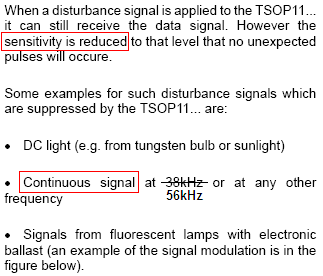

IR modules have more sensitivity to bursts of modulation. Their AGC reduces the gain for continuous modulation so they aren't sensitive to the ultrasonic switching of compact flourescent lamps.
