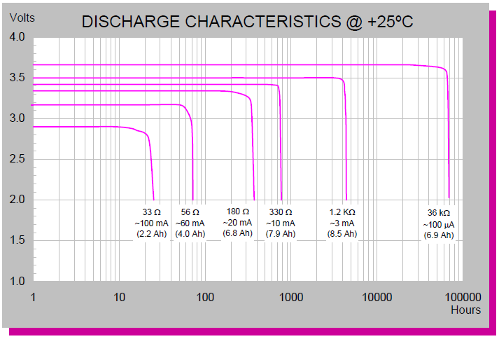

Here is a curve on the first battery I picked.
At 10mA of LED current, we have 800 hours of life.
At 3mA, we have 4000 hours or about 1/2 year.
At 1.5mA, the batter should last about the 1 year you want.
LT-5920 8.5Ah, 3.6V
So the real questions are:
Is this battery too large?
How much current do you need? (get a LED and try it)
There are other things to think about but this is a good starting point.

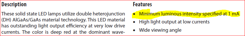

Here's an extremely low current LED (1mA at 1.6Vf, red): https://www.digikey.com/product-detail/en/broadcom-limited/HLMP-K150/516-1311-ND/637575, Check the datasheet (on that page - a PDF) for more info. In dark environs this might work for you.

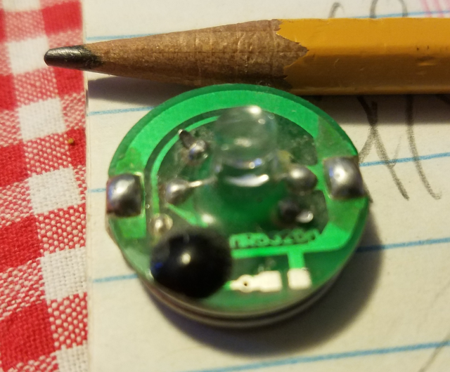

Here is a picture of something I was involved in some years ago. This thing is made by the millions. About any single color or there is one that randomly goes through 64 different colors.
On off switch by touching it.
Size=2016 battery.
Some have different modes, on, off, blink, fast blink,
Time= depends on color but about 40 hours. If we reduce the brightness that could go much longer. It is designed for full brightness on the LED.
This is the old version.
I have made much smaller but the "on/off/blink" goes away.
The short battery life is OK because you shut it off when not in use.
I think I can reduce the light (current) by 5:1 or 10:1 for any single color but I think the random color version might no have that option.

Ron, in your model you noted that an 8.5 Ah battery could power a 1.5mA LED for almost a year. I have found a battery that claims 10Ah https://www.tenergy.com/30123 that may be perfect for my application and cowboybob pointed out an LED that has a minimum current of 1mA https://www.digikey.com/product-detail/en/broadcom-limited/HLMP-K150/516-1311-ND/637575 . Would this setup light the bulb for well over a year?

Using the 1.5 LEDs draw and a 10AH battery will last about 9 months.
You may be able to calculate these observations yourself. There are 8760 hours in a year. Multiply that by your anticipated current draw (in mA), and the resulting number is the mAH rating of a battery to operate your circuit for a year.
Or it's possible to calculate the estimated time of operation, given the battery's mAH rating and the current draw. I'm on my phone? So cannot derive it now, but it can be done.
This just in. I found some 3mm flashing LEDs online. They draw 20ma. With a 10AH battery, they would last about 20 days. Take the batteries rating of 10000mAH, and divide it by 20mA, giving you 500 hours of (perfect) life. Divide again by 24 hours in a day, and get 20.8 days.
Note I specified "perfect". Batteries cannot be discharged totally, the the actual life is smaller.

The brightness numbers on the "efficient" LED at 1mA are the lowest I have ever seen. Maybe it must be in a pitch black room to be seen.
