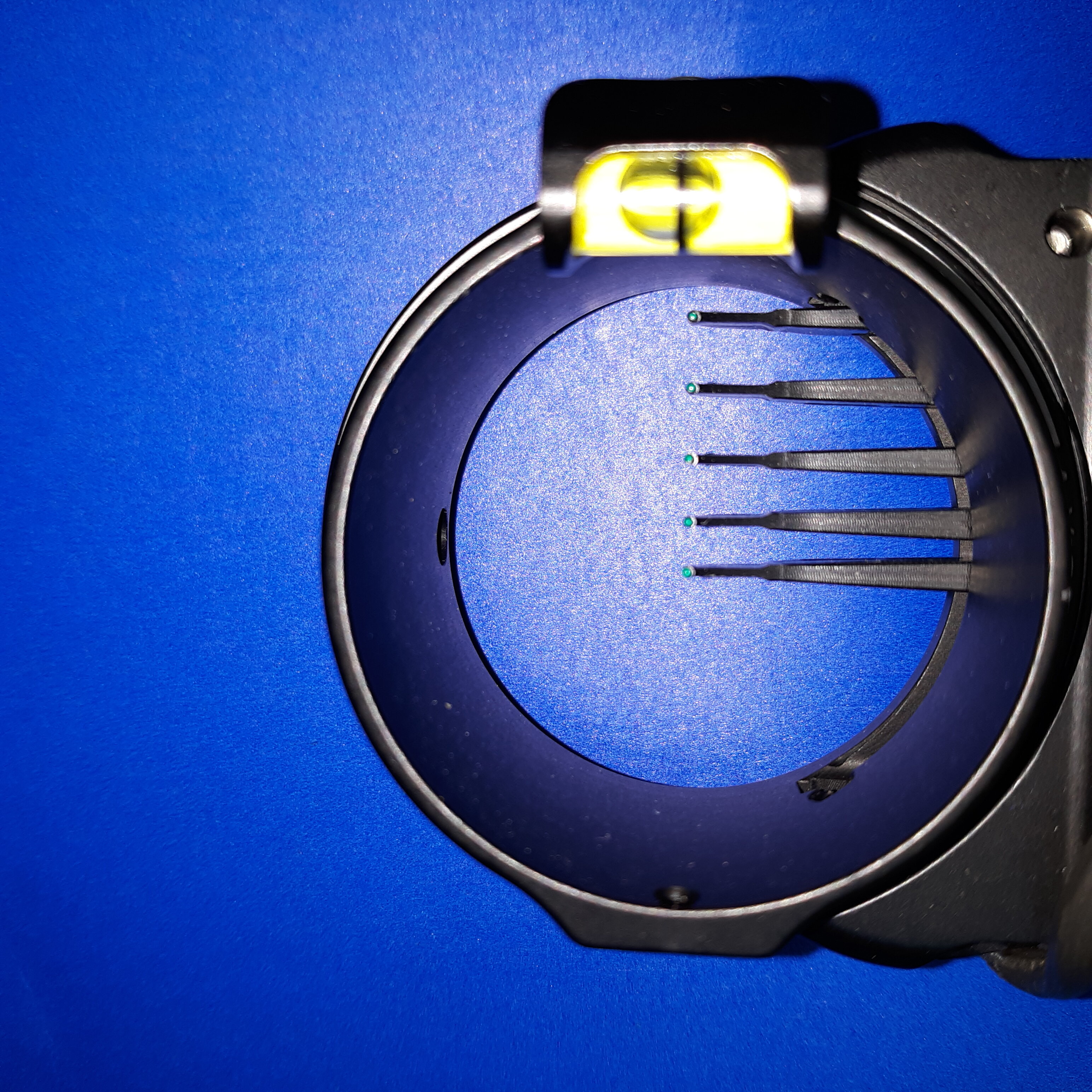

The green fiberoptic is a .010 strand of optic monofilament attached to a target bow sight that collects sunlight directing it to the end facing the archer that is used as a visual aiming point on the target.
OK, so it's intended for someone to look directly at the light source; that's a bit different to what I thought was required, from the original question; I took it to mean fibre end had to be visible at a distance in full sun...

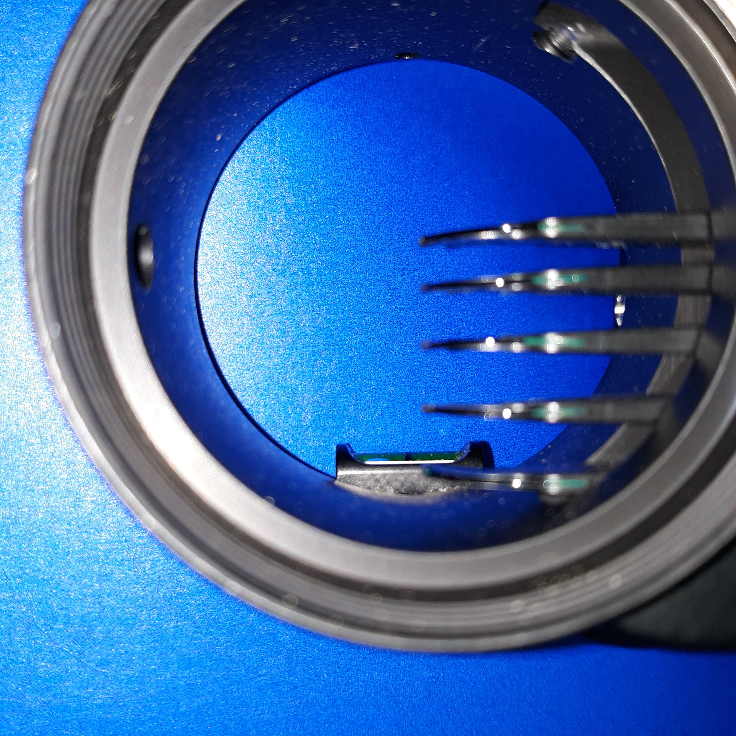

I'd be willing to bet that those sights use a green LED and a common clear fiber optic. The green LED is also better suited to a coin cell battery.

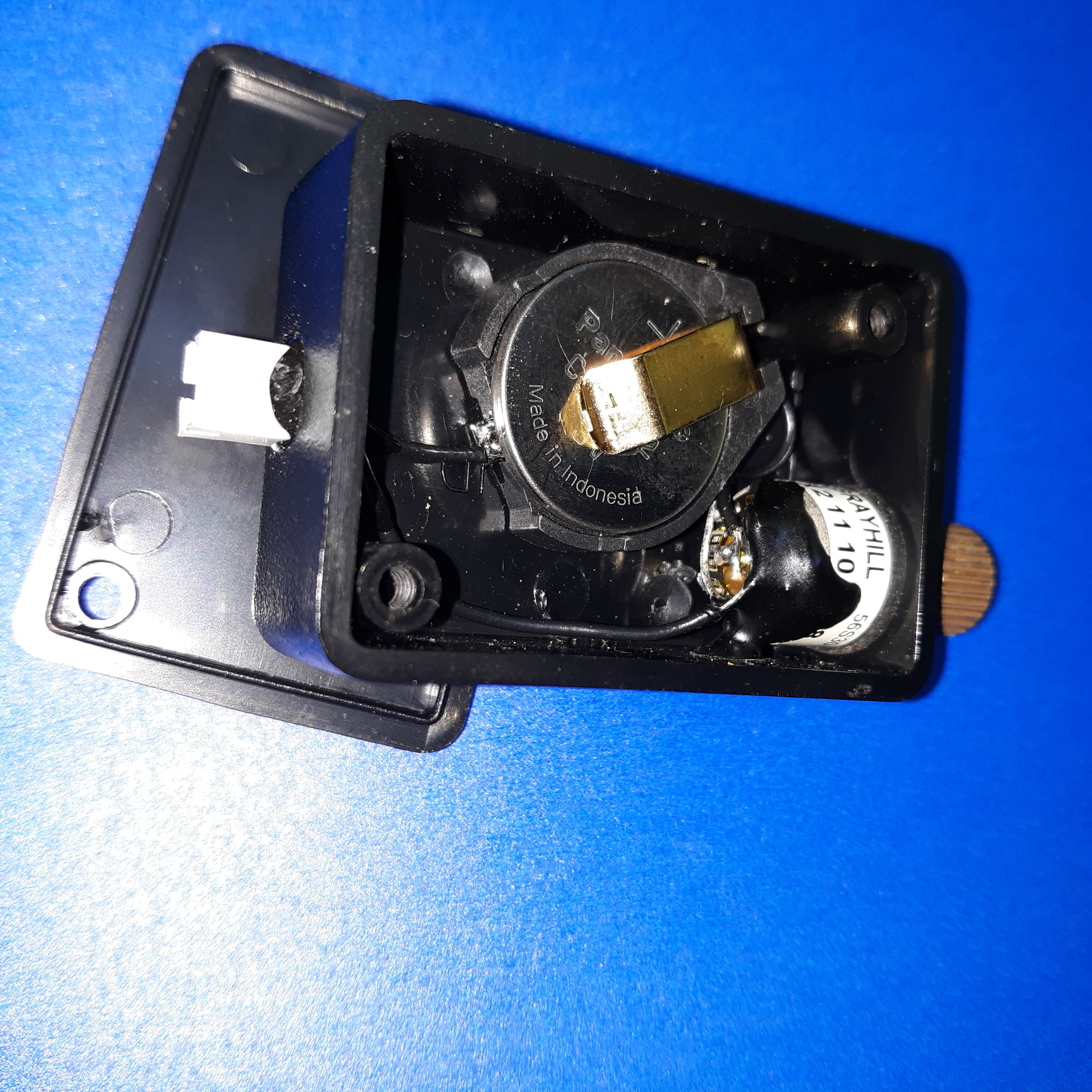

Again, thank you for your time. This belongs to a friend., and is what I am trying to replicate except with more dimming range. It retails for
$90.00.

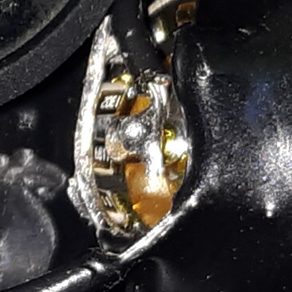

The switch is a grayhill 56s30-01-1-12n-f with off at each end 10 brightness settings 2 through 11. It seems to have just a conductive strip soldered to 10 positions. And no other components. I just need more adjustment past the low end . Can a potentiometer of ?ohms replace this switch? Please excuse my ignorance.
They are green and the light source is white. When the target is in the shade , sometimes the pin brightness on its lowest setting is too bright giving a starburst effect to these too old eyes.
The green led may be my ticket ! That will be plan "B"

That switch has a number of surface mount resistors arranged around the back; it's emulating a potentiometer but with steps rather than continuous rotation.
As Shortbus says, it must be a green LED than needs a rather lower voltage than a white one. Remember that a green (or any colour) LED can have a clear casing, they are not always coloured plastic.
Ok, I don't think those "Pins" are really a fiber optic. I say that because the light must be comming from the side of the pin. Fiber optics the light only is seen at the end of the fiber. That's why so many signals can be sent down a fiber bundle at one time and not get a cross talk of them. Your pins are probably an acrylic rod, acrylic allows light to escape from the sides.
I'm sorry my description was misleading. It's not signal quality fiber , but colored flexible plastic optic fiber Made by nanoptics specifically for this application.
