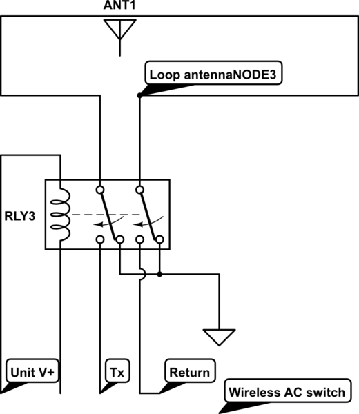

i would like to add lightning protection to my Automower 450X. The ground loop, which consists of five wires that run around the perimeter of the property and subdivide it, has to be disconnected from the transmitter/charger if there is the threat of an electrical storm. And of course the power disconnected. I would like to build a switch system that Disconnects and grounds the loop wires and cuts the power to the transmitter/charger.
With my very basic knowledge, I have an idea but I don't know if it's any good and I don't know what components would be best.
My idea is to use double throw relays to switch the signal wires to earth ground when the coil is not energized (NC) and to the appropriate transmitter terminal when the coil is energized (NO). A separate relay would be used to switch off the power to the transmitter.
In my case, a z-wave switch would be used to actuate the relay coils via a web enabled controller. This would provide the ability to control the system remotely and integrate with IFTTT Maker for automatic, weather specific operation.
I would greatly appreciate input from others on the idea and how it might be implemented to provide the best protection.

If you had a power interruption during a lightning storm, your system may still be connected. I would suggest the RF connects via miniature relay with NO contact and activated if power is available a low Voltage inside the unit could be used to enable the output and when powered off the DPDT could connect the external wires to gnd. or to transmitter when power is turned on. Thus only one toggle control.
So 2 wires to POLES and Tx to NO and GND to NC.
The ground should not be shared by the equipment but rather to a nearby ground rod to avoid gnd shift induced by lightning on the equipment.

I was thinking that the relay NC contacts should be closed in the power off condition and shunted to earth gnd so the voltage drop to the transmitter would be minimal on the NO contacts

I think the capacitance is too high for the RF. But suitable TVS's might be possible but if the Tx can handle no load on startup, for 50ms or so , it shouldn't be necessary. I'm not familiar with the output power and transients of open circuit during shutdown either and have not tested this. But If I saw more details I could tell.
Wont matter if the contacts are closed or not, unless its a huge relay with a very significant ground connection in the order or 16mm^2 it will just vaporise the contacts and everything will see a significant potential.

This is an RF loop antenna. A line filter would block the signal.
The relay shunts stray lightning pulses effectively to a good ground rod.
Normally a tree or a higher object gets hit.
Perhaps a series tuned LC filter in the Loop could improve a direct loop hit immunity, but a line filter is only good for direct hits to the line not the antenna.

The antenna may be grounded internally already. Diverting that ground externally won't help as the loop will pick up significant levels on the signal side with a yard sized loop.
I would still isolate the loop from the transmitter with the double throw relay and shunt to ground. Just wondering if this ground needs to be bonded to the service ground if all I am grounding is the loop. I think if I were grounding other line voltage equipment it would need to be bonded to the service ground. In my case the ground would only be for the loop when it is isolated from the transmitter.
