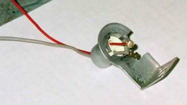

1 x 12v 15w/30w bulb it has 2 fillaments and 2 wires that connect to it.
What you need to do is ground the "case" of the bulb holder ( Connect it to battery - ). One of the wires goes to the battery through an regular on/off switch and the other through the brake switch. Choose the wire that lights the bulb the dimmest for the running light. I wouldn't use a resistor to dim the light. You'll waste way too much power that way. Use a lower wattage bulb or LEDs to save power.
He will burn more power using just the bulb (15W). Using a resistor, he is only consuming 7W of power. Thereby, extending the charge of his battery. True, resistors are very inefficient, but you either loose the power with the resistor, the bulb or both. Perhaps you meant a resistor would wast too much power as opposed to using LEDs or lower wattage bulb? If that's the case, I agree (As long as the bulb is less than 7W):) But my concern was the brightness of the bulb itself, since the current has been reduced by 55%. This is something the OP will have to check out and decide.
