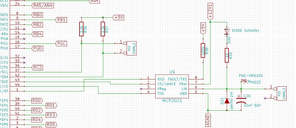

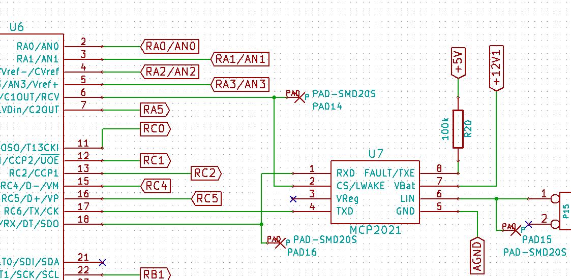

I'm trying to use LIN (local interconnect network) to connect two different PICs in two different boards. The goal is to use only one wire to pass information between them...
I'm using MCP2021 component from Microchip to achive that, one in each board and each board has it's own
power supply.
My question is:
I will need the same ground for transmission / reception in the two boards? It's possible to do it with
"different" grounds? Please see the circuit in attachment.
Thanks.

You can use different grounds and an opto isolator between the two PICs, but you will still need two wires to send the data (signal and return).
Your goal of one wire is not possible. You always need a return wire/connection along with the signal wire.

You need a common ground. So it's one wire (signal) and ground (return)
Just think of it like hooking up a battery, you need two wires.

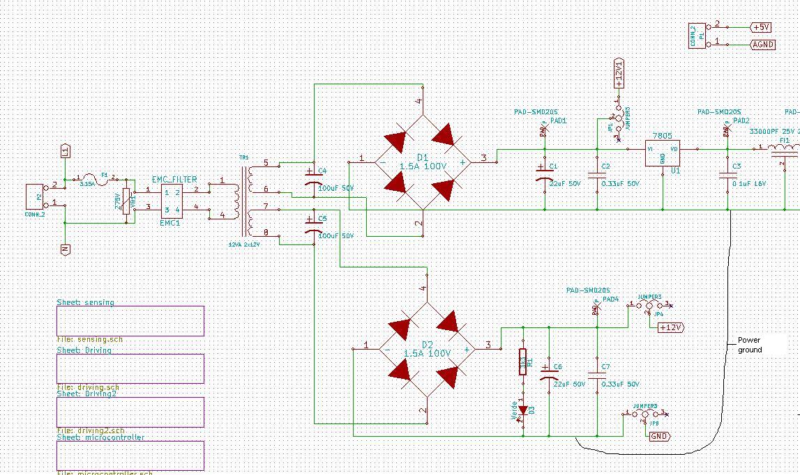

The 2 boards are 20m apart. The main reason is the convention... it's to be used in heat pumper and in the market almost everyone does these with 4 wires (F+N+Earth+signal) between the 2 boards.
Please see the attached schematic... it's the power supply i'm using (i have the same in the other board). Can i do the modification in the 2 boards like in the schematic? The earth is to be connected to chasis!
Using these and with the correct programming can i do one wire communication? I will have the return path?
Do you think it's the best approach?
Thanks.
