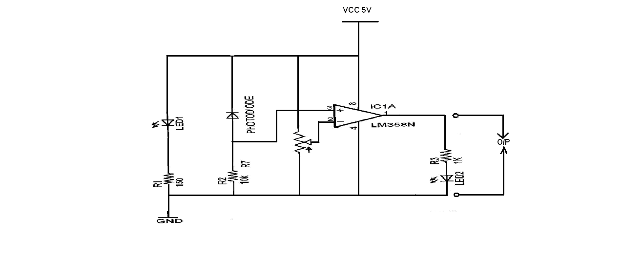

I have tried the following circuit, but my ics are getting burnt every time I try to use it. I have nearly burnt 10 ics.
Please assist.

Did he specify to use no prepackaged IC's because a comparator chip and a motor driver chip could make this a very simple project.
i think transistorian gave u the correst circuit ,test it on a simulation software if u hav one,if u don't don't panic it is very cheap.
Looks to me that it connects to the other lead of each motor (ie, the one that's not connected to + on the battery)
