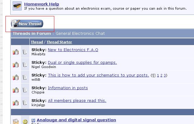

spamming other threads is not acceptable.
