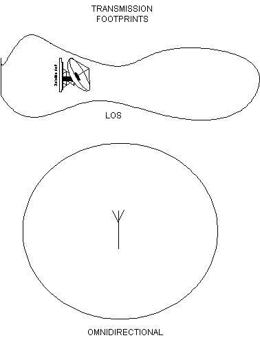

I hate to correct you, but this isn't true. An LOS transmission is one that is directional, as opposed to omnidirectional, and requires the transmitter to be pointed at the reciever. An LOS transmissions only limitation is the curvature of the earth, and major terrain features like large hills, thick forestry or mountains. In the Army, I operated a Line of Sight radio transmission systems node with three antennae on 15 meter masts. We lined our antenna up with azimuth and back-azimuth coordinates, and linked FM radio communication via LOS. We operated in UHF and SHF bands and sometimes had obstructions like trees and buildings in the way, but they were not enough of a hinderence to prevent the signal from transmitting through. Admittedly, the signal might not be as strong, but it was still adequate, and it WAS FM radio.

This is all true, but, I just wanted to dispell any confusion as to what line of sight really means. A LOS transmission can be radio, laser, IR, visible light, etc. Radio CAN be used for LOS communication too, all that is required is 2 DIRECTIONAL antenna (dish style) with 2-way radios, antennae pointed directly at each other, seperated by no more distance than the strength of the radio amplifer and curvature of the earth limit.

I would disagree with your suggestion!, but only on ONE point.
LOS doesn't have to be directional, two VHF (or higher) radio transceivers using quarterwave whips (which are omnidirectional) are 'line of sight' - there's no need for directional aerials.
If you both stand on top of hills, and can see each other, then the radio link works - if one goes down the far side of the hill then LOS is lost, and the link no longer works. In 'flat' country the limiting factor is obviously the curvature of the earth.
As already suggested, LOS isn't just an optical path, it's anything which works - and radio will work through some obstructions (houses etc.), although it generally weakens the signal.
Interestingly enough, some lower frequencies (the lower VHF ones) will actually 'bend' and work slightly further than theory would predict, by the time you reach UHF this effect is pretty well lost, and microwaves are almost optical in their LOS characteristics.
LOS is simply a way of describing the path (or channel) between transmitter and receiver antennas.
If you have LOS, there is nothing blocking your path. If you don't, you've perhaps got a building, trees, dog, etc.. in your path.
Yes, this is true, but this really defeats the purpose of LOS. We are getting into semantics here, but the advantage of a directional antenna is signal strength. Using the same transmitter power, an LOS directional broadcast is superior to omnidirectional if transmitting to a stationary reciever. I know most of you already know these things, but I think it is just good to post for the advantage of people who aren't aware of it. (Lest we forget the original poster who might be a student) Another aspect of LOS transmission (directional) is it is more difficult to intercept without knowledge of the antenna coordinates. Maybe the advantages in communication are mostly military, but they ARE there.
