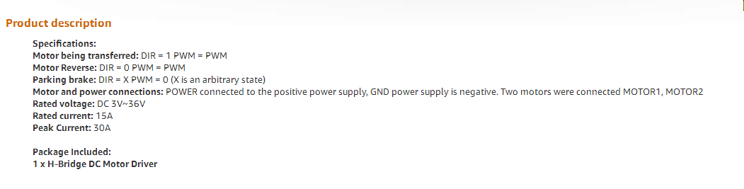

Here is the motor controller I purchased for the job
index.php
There is no real documentation with this controller, it appears that a +5v to the "PWM" pin and a ground to the "DIR" pin will allow it to operate at full speed in a particular direction.

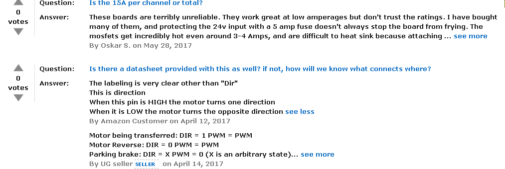

hi josh,
The attached clip is from the Amazon spec details.
The board does not use a negative voltage for the motor control pins, it is 0v/+5v PWM signal [ pulse width modulation]
I will look around for more info.?
E

Thank you Eric!
Are you saying that the Micro and driver board should not share a common ground?
