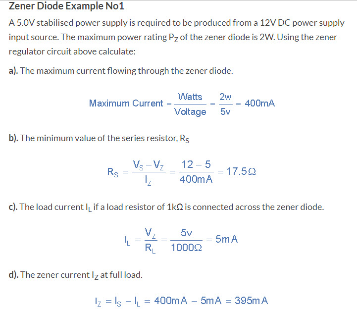

I was reading about a linear regulator using a zener diode, **broken link removed** .
I was going through this example on the same page and got confused when I tried to change numbers.
zener_diode_linear_regulator-jpg.121179
At zener voltage, V_z, the diode becomes an open valve and would permit any amount of current without significant change in the voltage; the current is limited by using a series resistor. In other words, at zener voltage the diode becomes a shunt.
Using the same circuit as shown in the example but assuming that R_L is 16.7 Ω and requires 5 V for its operation; it would take 5/16.7=300 mA. The maximum current supplied is 400 mA.
Would 300 mA pass through the load R_L and the rest 100 mA through zener diode? I assume that your answer is 'Yes'. Compared to the load resistor, R_L, the zener offers less resistance so more current should pass through it. Where am I going wrong? Thank you for your help.
Yes.
You are confusing yourself by making this statement:
A zener diode does not follow a simple Ohms Law relationship.
If you look at the specifications of zener diodes, they usually give a dynamic resistance, or zener resistance which is usually low, just a few Ohms.
This resistance represents the slope of the zener V-I characteristic.
If you wanted to produce an equivalent circuit for a zener, you would have this zener resistance in series with a constant voltage source.
This is where your thinking is wrong. At the zener voltage the valve starts to open and is fully open a few 100s of mV higher. So the zener will conduct as much as is needed to maintain 5V. If the load takes the whole 400mA then the zener will not even open a little bit - conduct nothing.

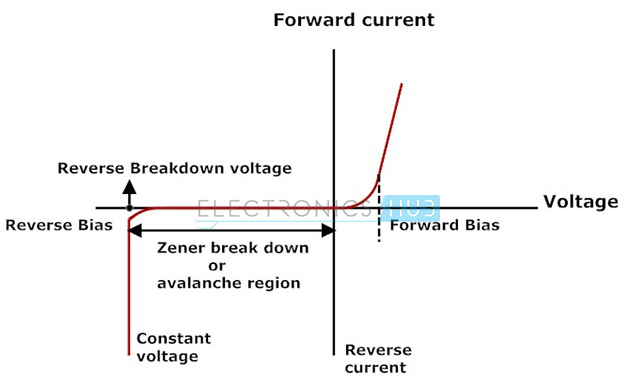

I was thinking more in terms of the following picture which is misleading and says that the voltage remains constant.
Source: http://www.electronicshub.org/zener-diode-tutorial/
Beyond break down region, zener diode behaves like a dynamic resistance (if V is to remain almost constant then R needs to change, V=IR) and it decreases as the current increases but this does not mean that the voltage remains constant. If zener voltage is 5 V and minimum required breakdown current is 5 mA, then if the current becomes 20 mA, the voltage might read, say, 5 V plus 100 mV. The dynamic resistance is maximum around the knee of breakdown region.
Now coming back to the original question, suppose that the load resistor, R_L, is not connected and the maximum allowed current of 400 mA is passing through the zener diode. The voltage around the zener would be 5V plus few hundreds of mV. When R_L is connected, the current starts passing through it. If at zener voltage 5V, mimimum required current for breakdown is 5 mA, and if at 5V R_L takes 300 mA then it would steal away 300 mA which was passing through zener. Now zener's voltage would decrease more toward 5V.

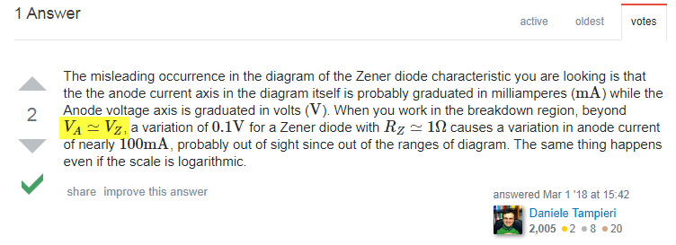

Question 1:
In the link above, ZR3, why the author is saying V_A ≃ V_Z? Actually the cathode, K, is being applied the voltage so it should be V_K ≃ V_Z. Perhaps, it's the convention to designate the voltage like this.
