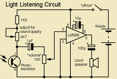

hello everyone, i'm working on the project of listen to light ,i reached to the attached schematic, can anyone discuss how the circuit operates (in detail plz), because i can't understand where is the source of sound and many other points....
THNX IN ADVANCE

Are you trying to communicate on a light beam by modulating an emitter with voice or music, or are you trying to hear environmental sounds?
Really it's a small project for the faculty, communicating on a light beam sounds good also (i'm free to choose any project related to my course) so can you give me a hint about this thread?!

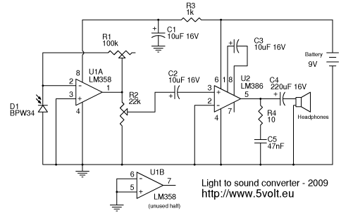

so any help for the first project i mentioned (knowing that i got another schematic while googling)

I predict that all you will hear with that is 100Hz/120Hz and harmonics from incandescent and fluorescent lighting.
why do you predict that?
and that in the first circuit or in the second?
The second circuit has more gain, which is good. The fact that you are not focused on putting optics around the photodiode means that your optical receiver will be detecting mostly ambient light from all directions simultaneously, and most lighting operates on the power line frequency.
The second circuit correctly has the resistor in series with the capacitor at the output of the LM386 power amp as shown on its datasheet. The first circuit is missing them.
I agree that both circuits will pickup mains hum from mains-powered lights unless you are in the middle of a desert where the noisy LM386 and noisy LM358 will produce plenty of hiss.
thnx for help but can i replace the lm358 with an op-amp implemented as a current to voltage converter, and the lm386 with an audio amplifier circuit (to be related to my course, i don't want a built-in audio amplifier nor built-in current to voltage converter)
If you mount the photodiode in the end of a long tube, or use optics, you should be able to make it directional. I did that once years ago, and could "listen" to the 120Hz ripple of incandescent light bulbs.
You may need some biasing and/or AC coupling on the input stage to prevent op amp saturation.
