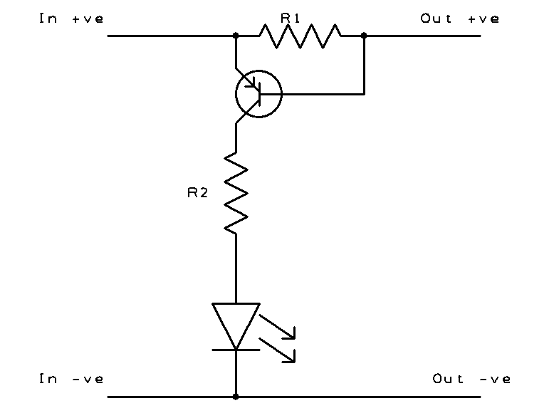

Hi all,
I've monitored both voltage and amperage for my PDA while it charged on a AC to DC charger and found that the voltage started somewhere around 7.2 volts and the amperage around .59mA. The specs on the PDA DC charger were 8.4v and .6mA output. Approx one hour and twenty minutes later (est.) voltage went up to 8.4 and amperage dropped to Zero. The last 20 minutes amperage was approx. .2mA or less.
My question is, Can I create a circuit that will light a green LED when amperage drops to Zero? This would not be the only lithium Ion battery that will be charging on this 12v DC cigarette lighter receptacle so DC voltage draw may vary depending on the device. I think the only constant I can count on is that amperage will drop to zero or almost zero when any lithium ion battery is charging. I think I'm approaching this the right way.
Thanks for any help.

I would also guess that you have been getting your units confused. The current will have been 0.59 A (which is the same as 590 mA).
It sounds like a typical Lithium Ion 2 cell charger. When the battery is low the current is limited. In this case it is limited to what the charger can give out. I don't know what device limited the current but it is correct that it is limited like that.
As the battery gets charged, the voltage rises. The voltage is limited to 4.2 V per cell, so 8.4 V for 2 cells. The current falls due to the nature of the battery. At some point, the current gets so low that the battery is considered charged and the power is cut off.
You have several batteries charging. I can't work out if you want a light to show when they have all stopped charging, or a light for each battery.
If you can measure the current at the 12V input that is better, because the devices after that will not mind if there is a bit of a voltage drop. The easiest way to detect current is to have a small resistor in series and measure the voltage drop on that resistor.
The circuit attatched is quite crude but simple. The transistor needs to be a PNP power transistor, as it has to be able to take the entire charging current through its base-emitter junction. The light will be on when current is above the limit.
R1 is set so that I * R1 = 0.7V where I is the current you want.
R2 limits the LED current. 1 k:eek:hm: will be fine.
The LED can be just about any LED you want.

Thank you for taking the time in lending your expertise. While this circuit may be simple it's a life saver and part of a larger project I'm working on. I will be charging off a 12volt deep cycle battery. Up to three devices could charge at the same time. I will apply this circuit to each of the three receptacles.
