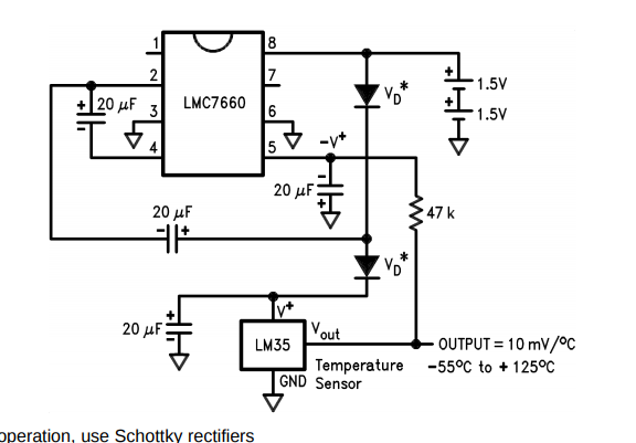

Now to figure where I can get 5 volts easy the board only has 3.3 broke out .
A 7660 will double the volts for you with just a few caps and the chip.
Something like this
Well found Burt.
Yes very much like that.
