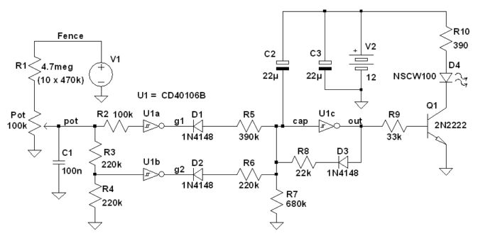

Hi all - I stumbled upon this site while researching how to build an electric fence status indicator. To give you an idea of what I am attempting to do is, build a simple circuit that would be able to flash an indicator light when the fence pulse is below 750v (Red), between 750v - 1500v (Yellow) and over 1500v (Green) that can be seen at night from a distance of 1000'. I have a small farm and being able to glance out the window from the house to ensure the fence is up and running quickly would be sweet.

The three values are what I've measured when it's been in operation. Anything between 750 - 1500 is working, but is arcing or has a moisture issue somewhere - usually as a result of an insulator slipping or breakingdown. Above 1500 and everything is good. I didn't know if it was possible or not. - There is a battery operated unit off the shelf that blinks when their is a problem, but I am always tinkering and thought it would be neat to build something like I described. Thanks everyone - Steve
Well, to answer the original question, yes, it's certainly possible. The basic idea would be to drop the fence voltage across a high resistance down to something on the order of a volt. Then you'd use a comparator to turn on lights depending on what the exact voltage was. For three levels, you could use one quad comparator chip such as an LM339.

How about this? Total component cost (minus housing) ~$2.
A voltage divider formed by a chain of 10 x 470k resistors (to limit the voltage across each) and a 100k pot (trimmer) taps off the fence voltage. At 1500V on the fence there is ~ 15V across C1 (which damps any voltage spikes) and the upper Schmitt threshold voltage of both gates U1a and U1b is exceeded so both their outputs are low. This enables C2 to charge via R5, R6, R7 in parallel. When the C2 voltage drops below the U1c lower Schmitt threshold U1c output goes high and discharges C2 via R8. The charge/discharge process repeats and the result is a train of pulses from U1c which turn on Q1 and hence the LED (a high brightness one). The pulse rate is about 1 per sec and the pulse width is ~ 200mS.
If the fence voltage drops below ~1500V (settable with the pot) gate U1b input is lower than the uppper Schmitt threshold so C2 charges through only R5 and R7 in parallel, reducing the pulse rate to ~ 1 per 2 secs. If the fence voltage drops below ~750V then both U1a and U1b outputs stay high so C2 charges through R7 only, giving a pulse rate of about 1 per 5 secs.
A single high brightness white LED should be visible at night at 1000ft and won't significantly drain the battery (assumed to be 12V).
