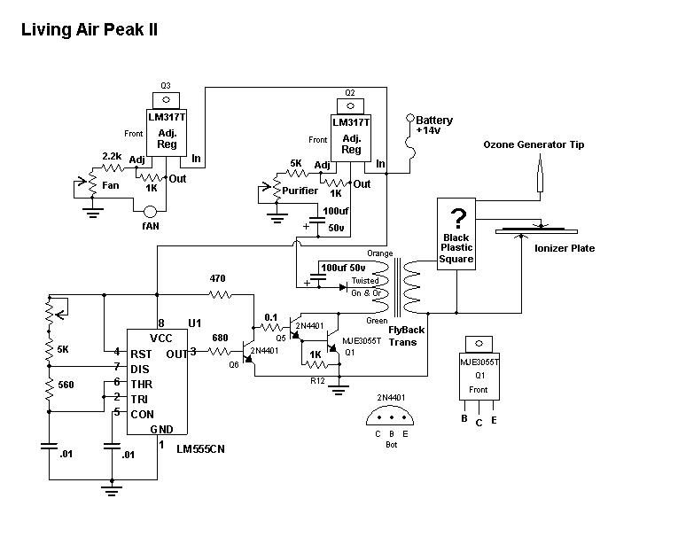

Living Air Peak II Schematic Diagram and repair
N11778
Its a nice unit, cost to much for the quality, but works good.
the two 100uf 50v caps were bad one had a bulged top the other tested bad.
replaced the two caps and its working fine.
