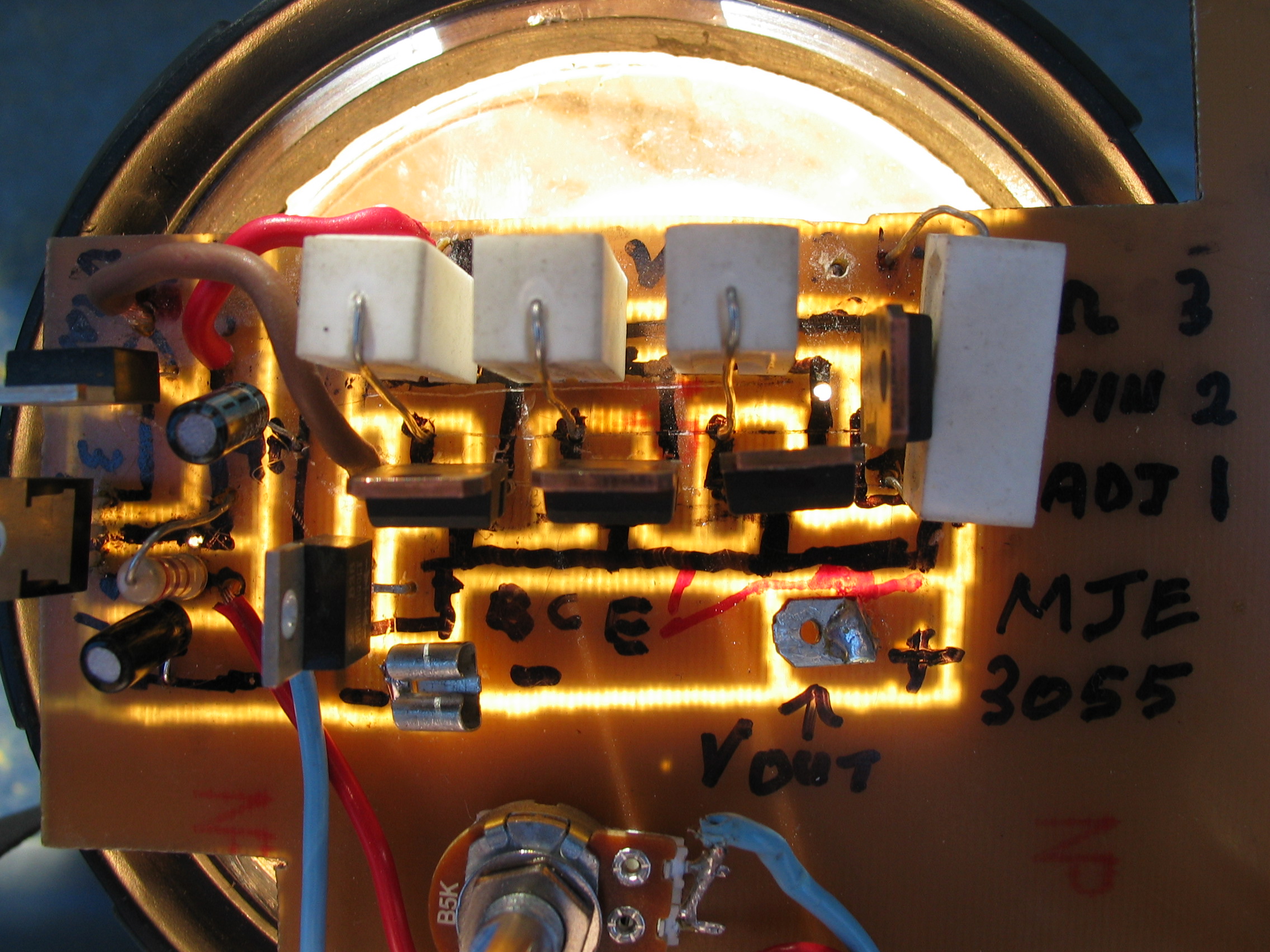

I am looking for 27Volts out at 12 AMP to drive a led light with 200 leds in the unit.I am using a DC battery to get the required power.
I will post photoes of the unit
Hope you can help me.

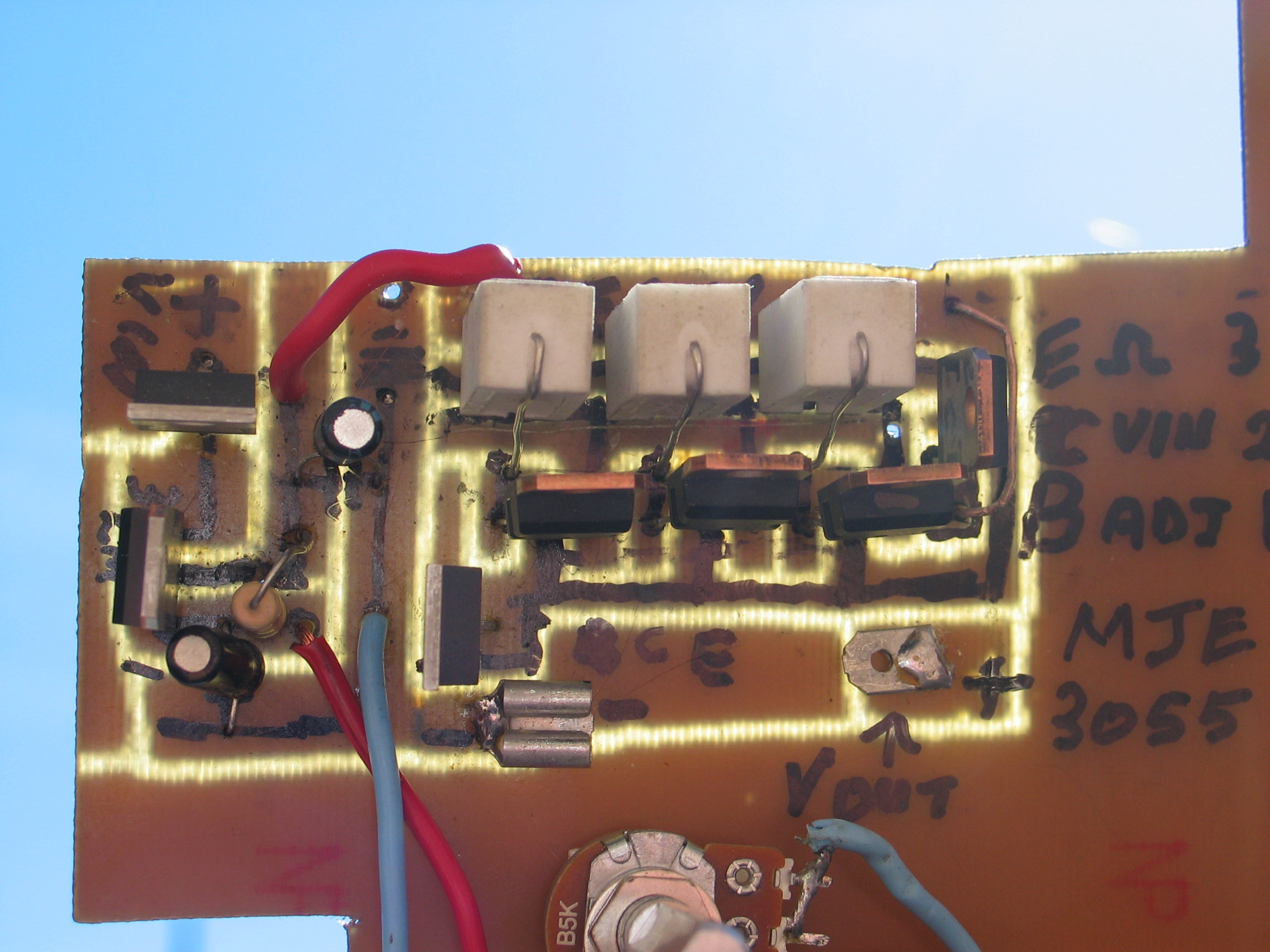

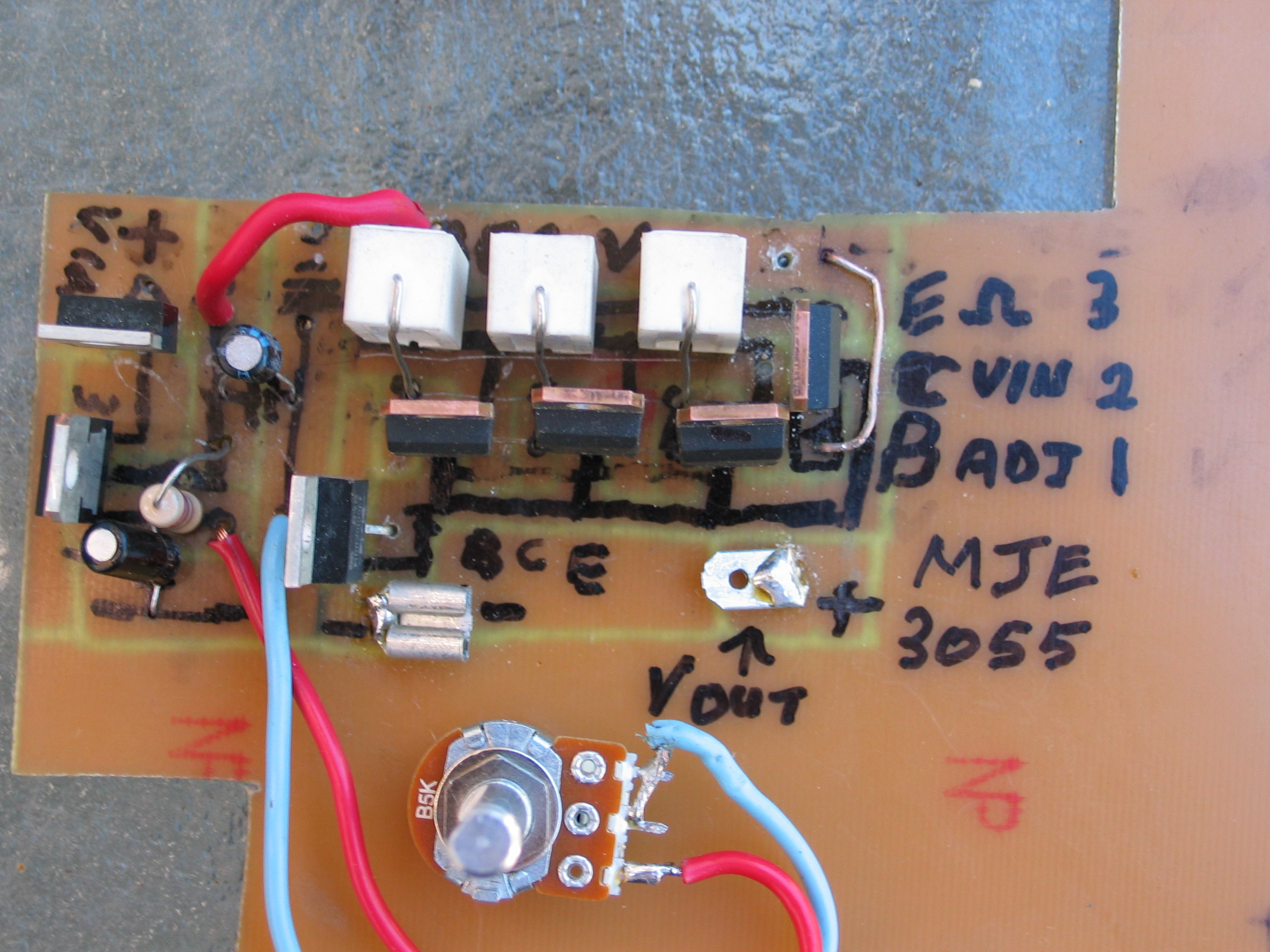

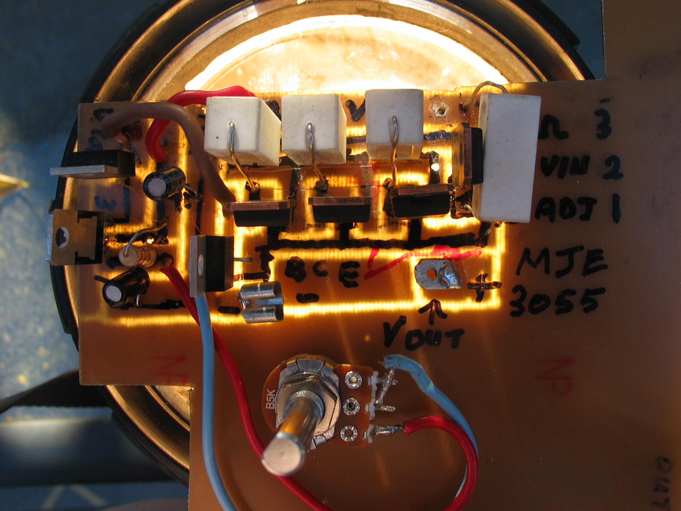

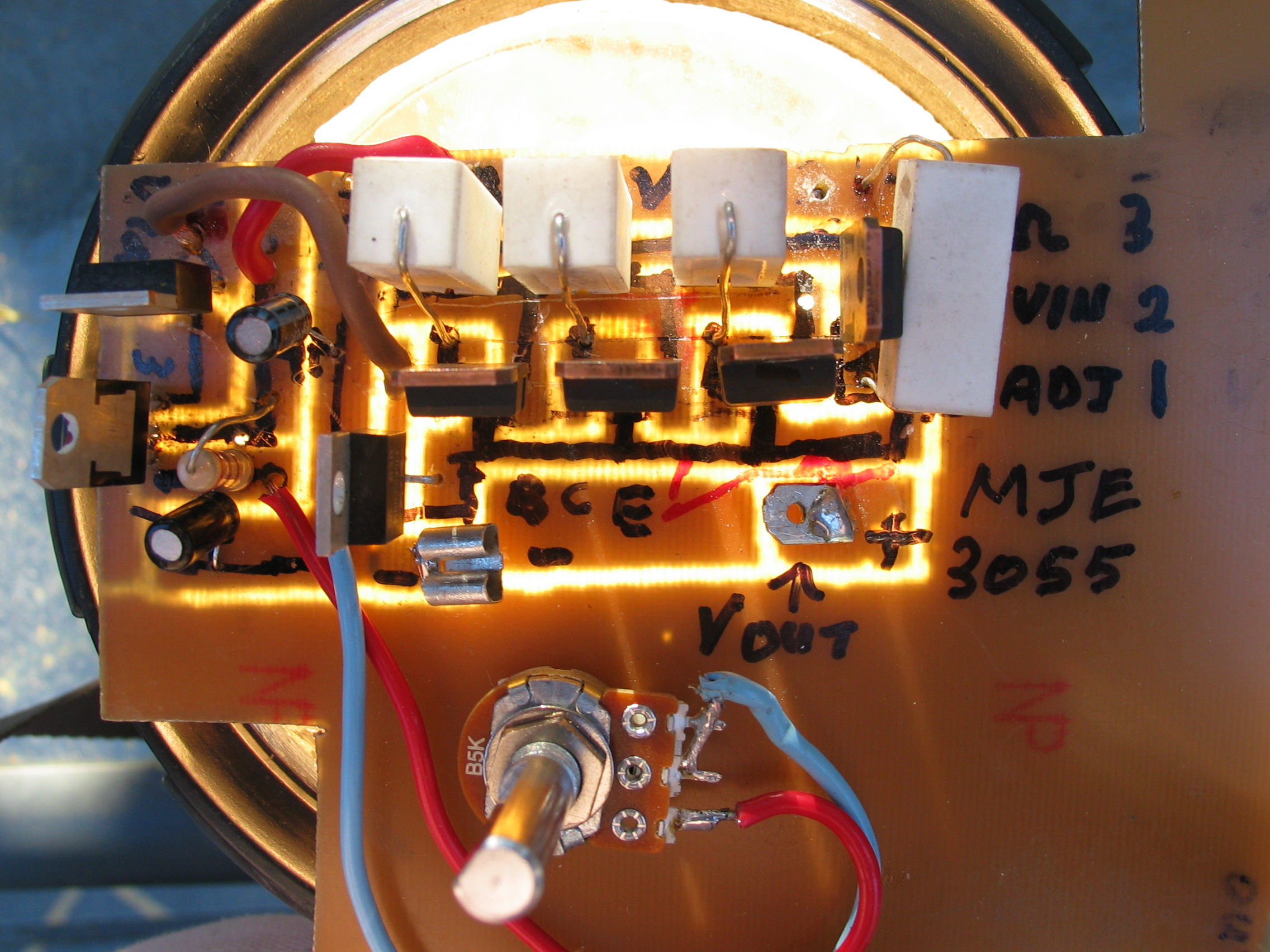

I the last photo you will see I have added a resistor and the brown wirer
This may help you to see under the resistor and wirer
I have not loaded the Circuit up at this stage.
If you require a photo of the solder side of the circuit board I can provide that

I have added a nother Circuit to the LM 317 which is working now
It has poor voltage regulation when the load current changes. Since the transistors are just simply emitter-followers their output voltage drops when the load current increases.
The datasheet for the LM317 (and for the LM7812) shows a PNP transistor at the input that has feedback to the LM317 so the voltage regulation is perfect. The PNP transistor can drive many NPN transistors for very high output current with good voltage regulation.

The circuit Audioguru suggested is a much better regulator, so that would be advisable if you are using a battery as the battery voltage will vary. I think you could keep your PCB and the power components and modify it, but a far ebtter idea would be to use a decent heatsink for a start and put your power components on the heatsink then design and build the circuit around that. It may not need a PCB as the main power parts are physically mounted on the heatsink and you don't need much more than a LM317 and a few discretes which can be wired point to point to the power transistor legs.
Before rebuilding it would be good to outline what the battery is, what the usage is for etc and people can suggest the best options of what circuit to use and how to construct it. :)
