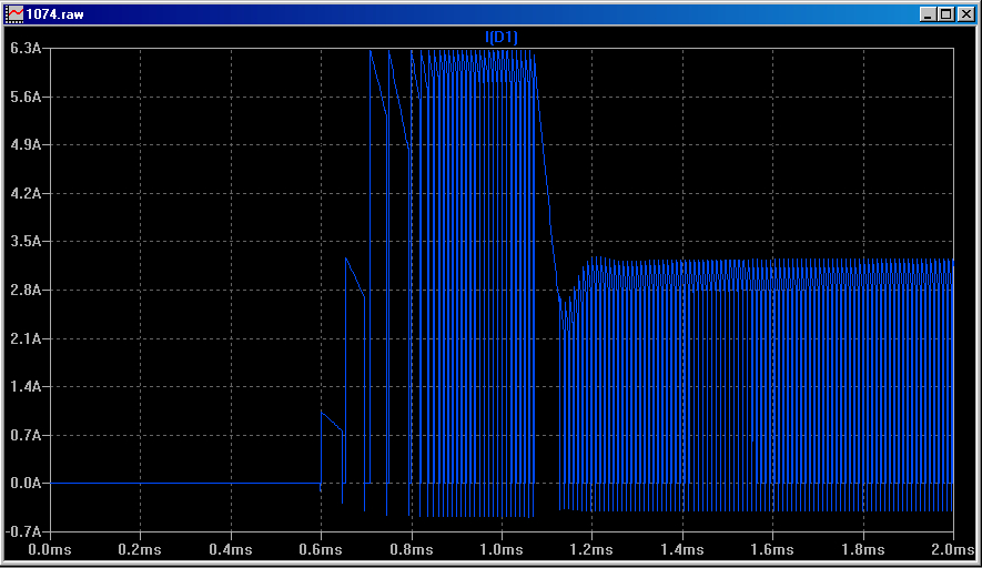

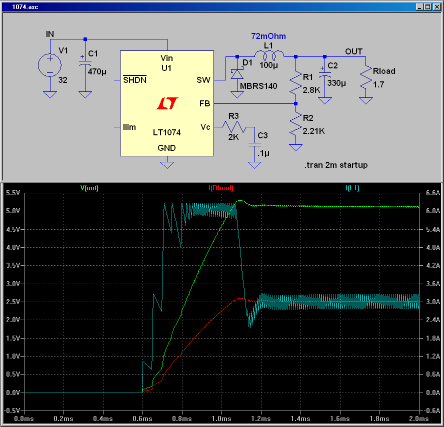

You are forgetting that to get 3Adc at the load, the peak current through the inductor could be up to ~6A. It is the peak current that determines which inductor you need to buy. The buzzing/heating of the inductor you are using now is likely caused by core saturation because you are exceeding the inductor's 2.6A peak rating.
Here is a sim of a similar LTC step-down converter. I put in your voltage, current, and inductor values. Note that just to get the converter started, the peak current in the inductor is over 6A.
The diode current is shown in the second attachment.

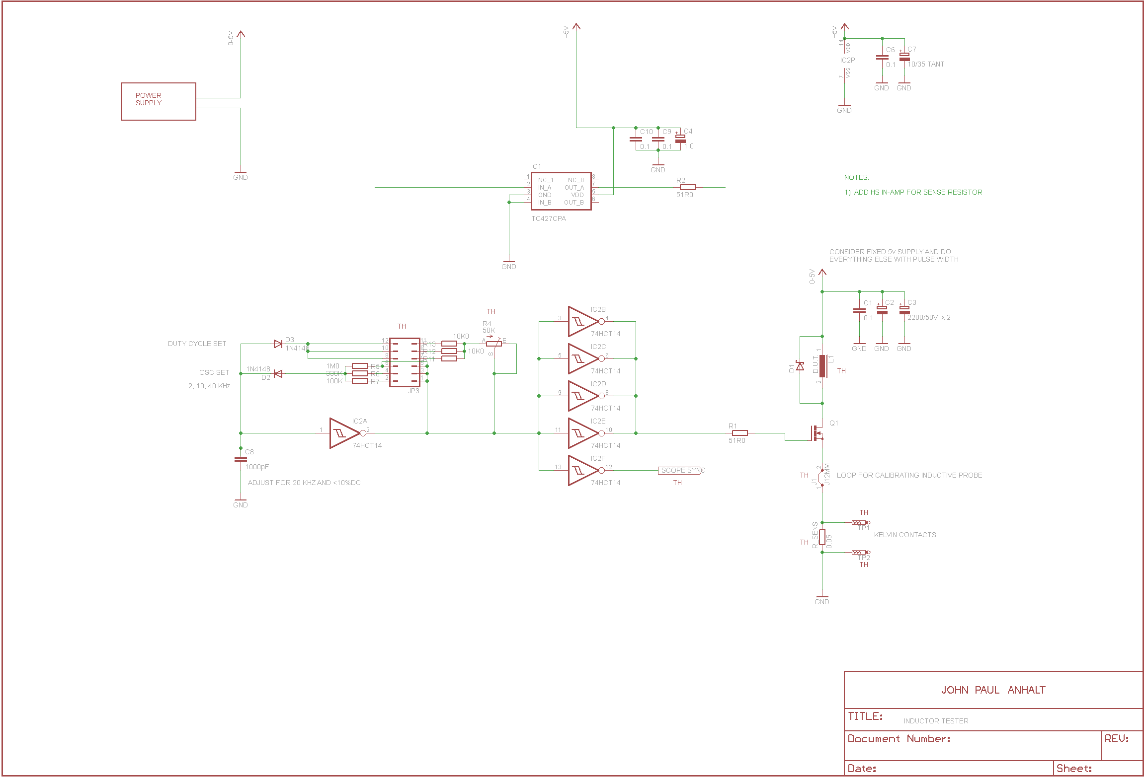

I built a nifty and simple little jig for testing when inductors saturate, I'll find the link for it if you like.
I found manufacturers ratings to be on the optimistic side.
Here is the link for Dekker: https://www.dos4ever.com/flyback/flyback.html#ind2
Here is my version:inductor test bench.png

To say the least, it was both fun and educational to experiment with various inductors (mostly toroids) to see the effects of core saturation. I even talked CoilCraft into selling me a calibrated coil to play with.
Here is my version:View attachment 75509

Your better using a 'scope and look at the current accross a load resistor, like the 0.1 ohm in the test jig I linked you to.
The test jig can also be expanded to get an idea of switching losses, however you need to get to that point first.
