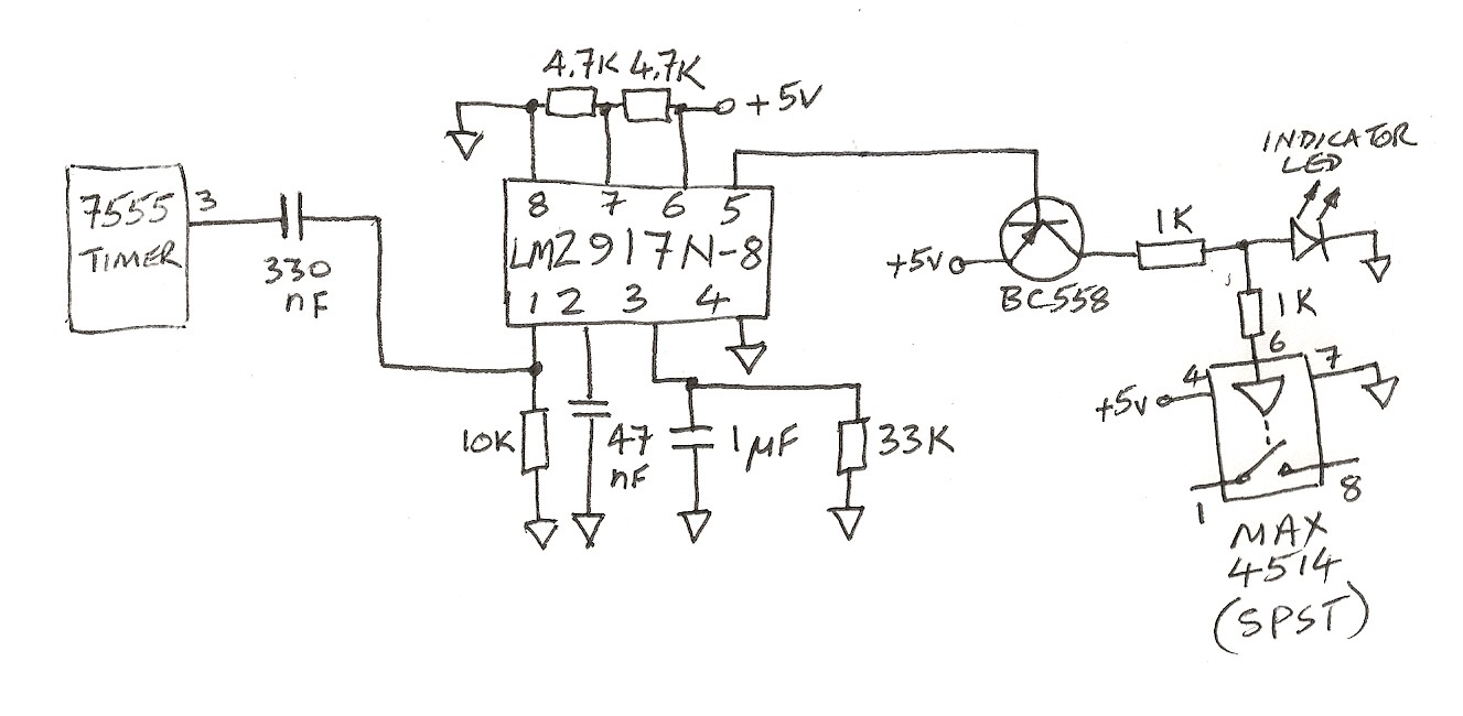

My circuit uses a 7555 chip as a monostable pulse generator that is triggered by a light sensor monitoring the speed of a perforated rotating wheel. The timer is used to clean up the signal and provide a clean square wave output. The signal passes to the LM2917N speed switch that is set up to give a high output on pin 5 when the input frequency passes the reference level. The output signal from pin 5 then goes on to trigger the analog switch and the LED.
It works, but the response time seems slow and inaccurate. It could be because I am using the 8 pin chip and should be using the 14 pin version. I'm not sure. If there are any other faults in the schematic please let me know. Thanks!

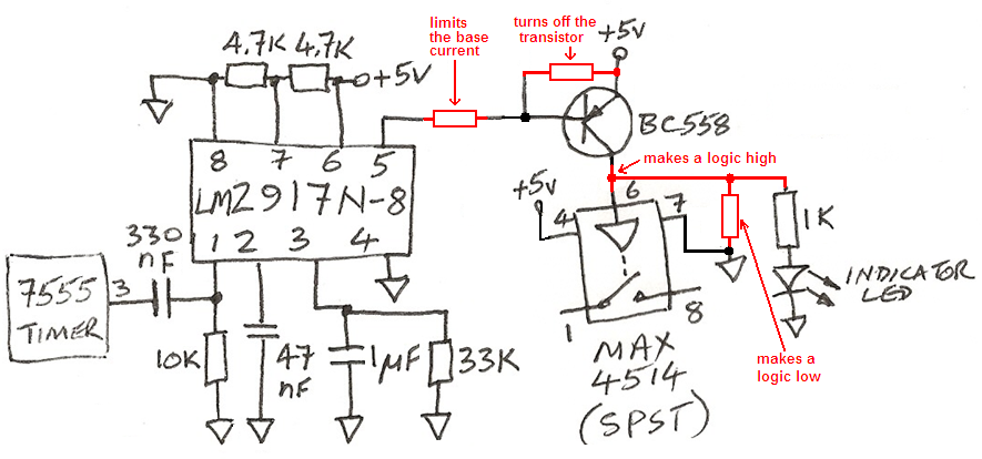

I saw some missing resistors.
Try it like this:

Thanks Again AudioGuru,
I knew I'd left something out. That's the trouble with being an ME and not an EE! Could I ask you to give me some ballpark figure for the resistor values? Thanks.
Incidently, if I pass an audio signal through the analog switch, do I need to have the chip wired to a +/- 5v supply or can a single +5v supply and ground be used?
Vielle568
Your Cmos switch has a 0V to +5V supply so its signal must be biased at half the supply voltage at +2.5VDC.
