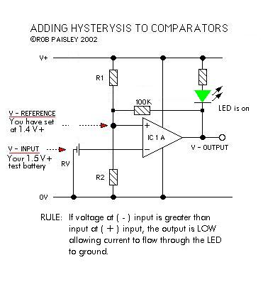

When the value gap comes like this Pin3 = 1.4V & Pin2 = 1.41V the LED started to blink like pulses. It cannot recognize suddenly.
You need to add some hysteresis as noted below:

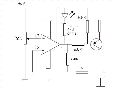

Thanks kchriste your hysteresis method worked well. Now it won’t give any pulses when the input voltage gap becomes very small.
When the output pin becomes HIGH its showing 5V.
1. But when the output pin becomes LOW its showing 2V.not 0V.So when I take an out from here to another IC will it be a problem? Also I need to invert the logic level.
2. Also without the battery if I adjusted the reference voltage to 1.4V, after connecting the battery its dropping down to 1.28 something like that is it real..?
Your schematic is missing some wires. The output pin 7 of the LM311 will go close to ground as a low if pin 1 is connected to ground.
Make sure pin 1 of the LM311 is connected to ground as noted by AudioGuru... The output should be less than 0.7V when low, for the load you have in the schematic.
You could use a transistor, inverter or a different logic gate.
I assume you are talking about the voltage in pin3 of the LM311.... Check the 5V supply, I suspect it is dropping to 4.6V or so when you connect the battery.

The battery (cell) as shown in your and KChristie's diagram is in the wrong place. See the attachment below.
You want the output low, in order to turn on the PNP transistor.

I looked at the schematic and concluded it was a battery charger, in which case the battery was in the correct location.

I looked at the schematic and concluded that "the small project" was a battery charger. As you can see, the PNP is a current source which charges the battery until the battery voltage reaches the voltage set by the pot. Then the current source turns off.

A little about my circuit,
Earlier I planned to use this comparator as a battery charger. When the batteries charged to a certain level the output goes high & turn off the transistor.
I need to give the LM311 output to the CMOS because I need to connect an alarm to the circuit. When the battery is fully charged it’s giving & alarm.
