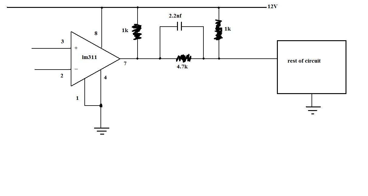

Hi, i'm not sure if part of my project is working correctly.
Its from a magazine, and on their diagram output at pin 7 of the lm311 a rectangular waveform is shown.
The inverting input is aprox 100khz triange wave and the non inverting input is aprox 5V dc. (see pics) (i've used 10x probe so voltage on pics are 1/10 voltage)
(The noninverting input will carry an audio signal later)
The output will be a pwm signal.
However on both my project and a circuit i've built on a breadboard to try and work out what ive done wrong i get a non rectangular output at pin 7. As shown on pic but its not a clean trigger, i just captured a split second image, its actually jumping everywhere
Is this the output correct? If not what do you think i've done wrong?

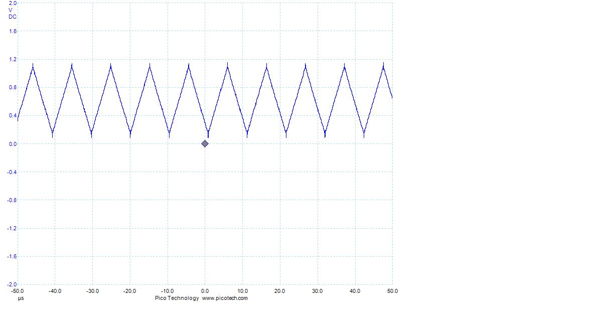

What's the peak to peak voltage of the 100kHz triangle-wave?
What's the DC bias on the inverting input?
The signal on the inverting should swing through the voltage at the non-inverting input to get PWM.

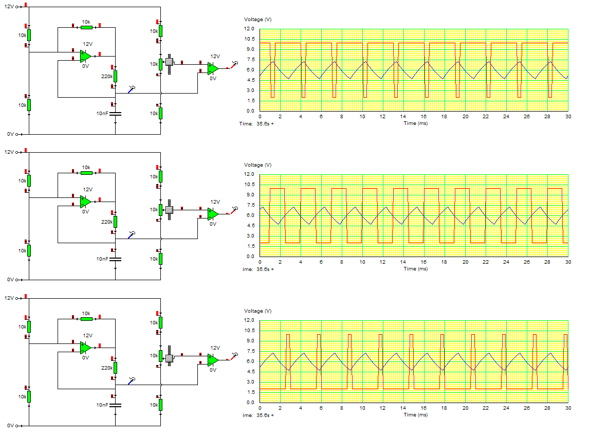

Here's a simulation of a PWM circuit consisting of two op-amps. The first one generates a 400Hz sawtooth/triangle wave, the second acts as a comparator. As you can see the output only changes from on to off when the waveform crosses the voltage set on the potentiometer.

As shown in my captured waveforms:
Vpp of triangle wave is aprox 11V
DC bias of triangle wave is aprox 5V
I understand how the comparator works to achieve pwm, what i'm not sure of is is the output at pin 7 correct for the given inputs.

Your output will be a square-wave if the 2.2nf capacitor, 4.7k resistor, second 1k resistor and "the rest of the circuit" are not connected.
Yes, the 2.2nF capacitor will have an impedance of 720R at the fundamental, much lower at the higher harmonics.
We don't know what load it's driving because we don't know what the rest of the circuit is.

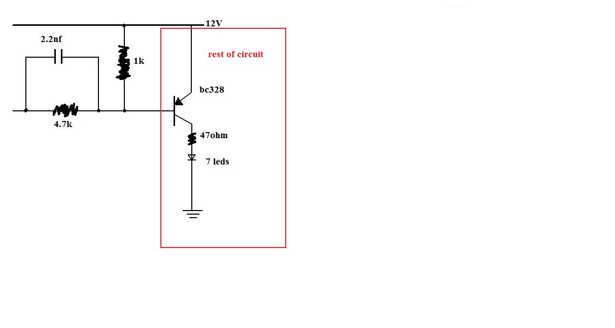

The rest of the circuit is a transistor and leds, sorry i assumed they didnt affect the output at pin 7.
I've attached a pic
So is the output i am getting at pin 7 correct?

This is why it's important to post the whole circuit, even if you don't think it's important, it might be.
It turns out that it's totally wrong.
What's the forward voltage of the LEDs?
Unless they're infrared LEDs then the chances are the voltage drop is too high for 12V.
How much current do you want for the the LEDs?

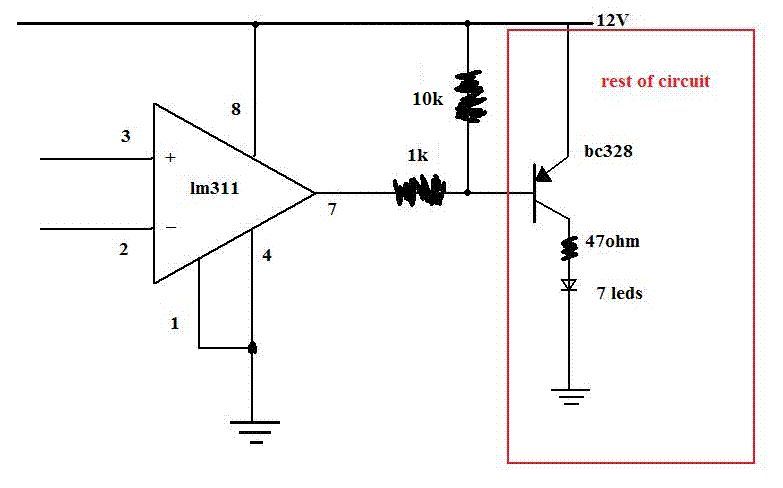

You could get rid of the transistor and connect the LEDs directly to the comparator output. The LM311 is capable of sinking up to 50mA so the chances are you don't need a buffer transistor.
For your reference, here's how to do it correctly with a PNP transistor.
Because it's a PNP transistor, there's no need to have a pull-up, the 10k resistor only helps to speed up the turn-off time of the transistor.

It appears you've got too much loading on the output. The confusing thing is I would expect the output to be nearer 12V than 0V so maybe you have mis-connected it.
I don't see how adding a high-pass filter will make any difference after the PWM circuit. If you want treble boost then it needs to be before the PWM circuit and there needs to be a treble cut at the receiver to stop it from sounding distorted.

The 2.2nF capacitor acts like a 720R resistor at 100kHz and a short circuit at the higher frequency harmonics (a squarewave has infinite harmonics)
You want a rectangular wave for PWM, I suggest using the the circuit I posted above.

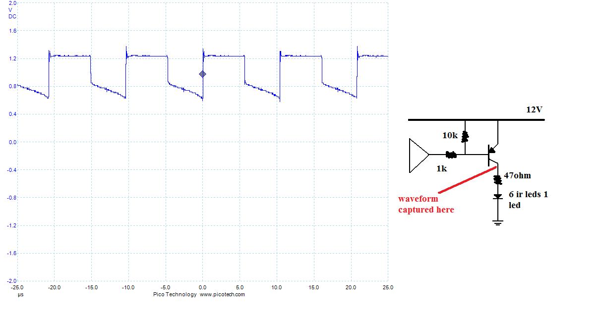

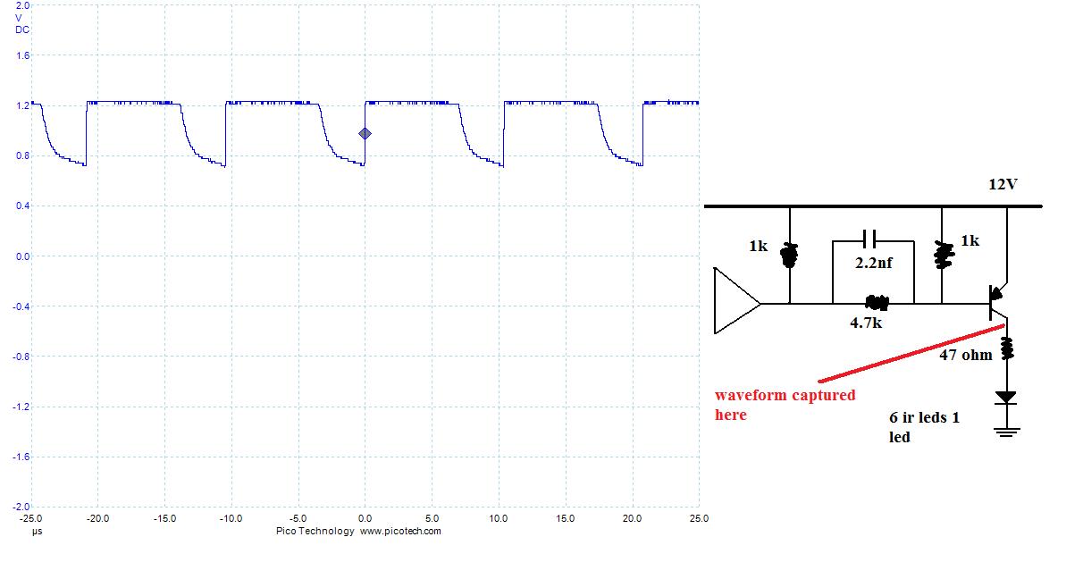

What really matters i guess is what the waveform across the leds will be and i've captured both the waveform of the original circuit and your (heros) solution.
Is one to be preferred or will both work?

It seems odd that the waeform doesn't hit 0V, it's possible that background infrared radiation is causing the LEDs to generate a small voltage.

Once the collector voltage drops below the cumulative knees of the LEDs, they become high impedance, and the discharge path for the collector capacitance become close to an open circuit. The voltage would get to zero if the frequency were very low.
