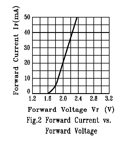

Below is a graph of current vs voltage (v-i or i-v curve) in a typical red LED. You LED scale factors may be different, but the shape of the curve is the same for all LEDs. Notice below that if you set the current at 10mA, the voltage across the LED will be about 1.85V. If you make the current 20mA, the voltage will be 2.0V. They are inextricably tied together by the v-i curve. Change one, you change the other. If you look at the curve, you can see that, because the curve is so steep, application of a voltage would result in a large current change for relatively small changes in voltage. This is why we bias LEDs with current instead of voltage. The problem is made worse by the fact that individual LEDs of the same type will have slightly different curves, so you would get different currents in different LEDs for the same applied voltage. In addition, LED light output is specified as a function of current, not voltage.
I hope this makes sense.:)

One other interesting fact about the way the current/voltage in
an LED works is like this...
In the graph posted by Roff, if we let the voltage change from
2.0v to 2.1v the current changes from 0.020a to 0.030a.
That's a 50 percent change in current for only a 5 percent
change in voltage! So another view of the LED is like that
of a zener diode, and it should be biased in a similar way.
Also, 5 percent is to 50 percent as a 10x increase
(we change the voltage by 5 percent and get a
50 percent change in current), or
10x sensitivity to a change in voltage. Looking at it
from the standpoint of the current, it's 50 percent to
5 percent (we change the current by 50 percent we only
get a 5 percent change in voltage), which is only a
0.1x sensitivity. Thus, it's better to regulate current
because for a given regulation point error E percent
in the primary regulation parameter the LED will experience
an S*E change in secondary parameter (S is sensitivity)
and this works out to a more accurate circuit when
regulating current. If this isnt clear i can illustrate.

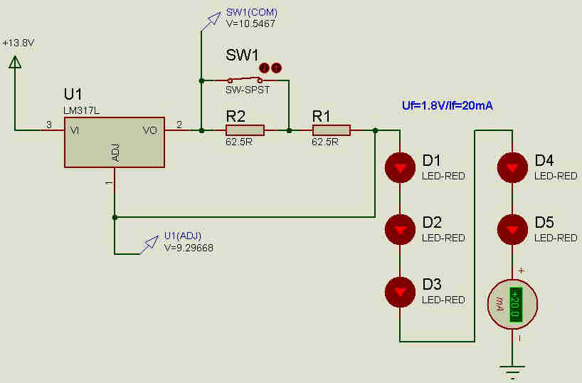

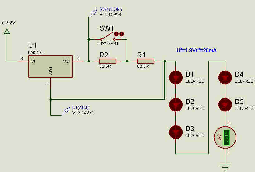

Hi RogerTango,
connecting low current LEDs (≤ 100mA) to an LM317 you might choose an LM317L (T092 package). The LEDs really don't care for voltage if their nominal operating current is applied. The forward voltage drop will adapt automatically to the current.
Depending on the supply voltage you can connect LEDs in series. For a rough calculation you might use this formula:
+UB=(nL+1)*(Uf)+Uref, where +UB is the supply voltage, nL=number of LEDs, Uf=LED forward voltage, Uref=IC reference voltage, e.g. connecting 5 red LEDs (Uf=1.8V) in series using a supply voltage of 13.8V their total Uf is 10.8V(6*1.8V). Subtracting 1.25V reference voltage from the remainder of 3V your safety margin is still 1.75V (~Uref*2, including Uref). If the forward voltages of individual LEDs vary there is still enough to "play" with.
The feedback resistor (adjust) is calculated: Rfb(Ω)=Uref(V)/If(A). So for 20mA forward current the resistor should have a value of 62.5Ω. (Rbf=1.25/0.02)
Refer to the attachment to see it does work that way. (two series resistors are fitted to see the difference. The output voltage and reference voltage input always differ by Uref(~1.25V))
Regards
Boncuk

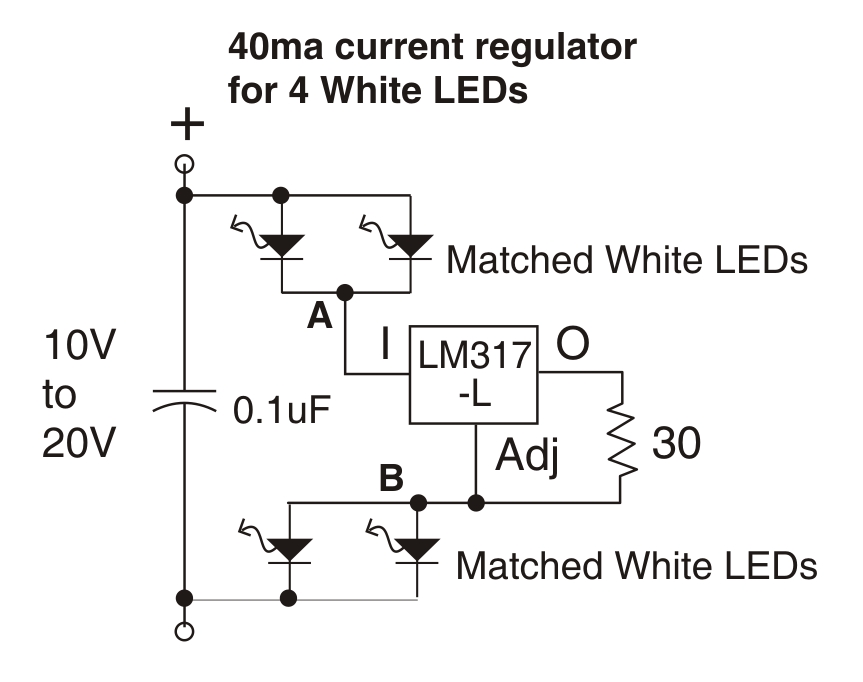

I googled this simple 40 mA LEd driver
The OP states :
“This is a minimal parts lamp made with four white LEDs. It features regulated light output from 10V to around 20V.
The LM317L and resistor act as a current regulator set to 40ma. Current flows from the battery through one pair of LEDs, through the regulator, through the other pair of LEDs, and back to the battery. The capacitor filters out noise on the power supply lines. The LED pairs must be matched so that the current through them is roughly equivalent (normally, a batch of LEDs from the same manufacturer will be matched close enough for this application.
Small resistors could be placed in series with each of the four LEDs to improve the balance.
Now for the questions :
1) Is this electronically correct ?
2) Theoretically, what Voltage should I expect at point A & B, If I decide to put the resistors (one for each LED)
3) I guess when regulators are used for current, they adjust the voltage automatically. Will the project work If I replace each pair with a single Led (Rated 3.4 V, 40 mA) and supply 6 V.
