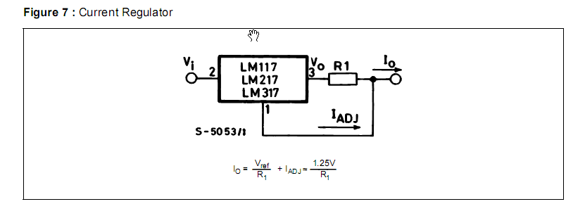

No, look at the datasheet for LM317, the current limited app notes.
Just a single resistor in the output that will limit the current to 990mA.
The output 'voltage' will become 3.3V
Do you follow OK.?

1.27R at 3W to 5W

The 1.25V is an internal voltage refrence of the LM317.
The formula for Current limit is 1.25V/R1
So R1= 1.25V/Icurrent
If you wanted sat 100mA, then that would be R1 = 1.25/0.1 = 12.5R
For 1amp say R1=1.25/1 = 1.25R and so on...OK.?

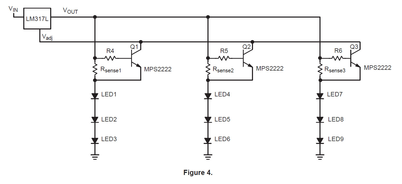

i want to askanother question!!!!!!!!!!!!!!!!!!!!!!!!!!!, again about LEDs...
If I wanted to power a heap of them...
it would be cheaper & Easier to USE LM317T because It can regulate to a voltage precisly!!
the led I would use is say 3.3v forward v. & Forward of 20ma
If I was to use the Regulator set at 3.0volt and use wow! how amny.. 20ma/ LM317 capacity 1500MA
thats a HEAP of leds.. without requiring resistors!?!?!?!?!?!?!?!?!1
this is another way but involes so many parts! I would require so many transistors.

As I said back at the start of this thread, you DON'T regulate the voltage, you regulate the current. Your idea would either not work at all, or blow the LED's.
For multiple LED's wire then in series, and feed them from the same constant current - the number of LED's depends on your source voltage.
