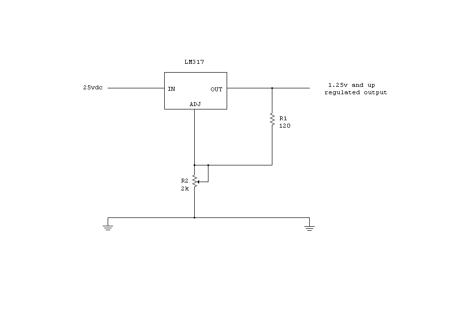

Hi there,
[Please see attached circuit diagram]
As many of you know, the LM317 is a simple voltage regulator that can be used in a very simple circuit in order to provide for a continuously variable power supply with reasonable temperature compensation. That circuit is shown in the diagram. The intended application is a very low cost variable power supply for general purpose testing so it doesnt have to be super perfect, but it does have to have reasonable temperature behavior like the LM317 already has.
There is a slight problem with the circuit however. Potentiometers are not perfect devices in that sometimes when they fail their 'arm' opens up either permanently or sporadically causing a change of resistance from some low value to some very high unpredictable value (same effect causes static in audio amplifier volume controls). This change in resistance could easily cause the output to jump from an adjusted point of say +5v up to as high as +22v in the circuit shown, and this would quickly blow out a device that was being tested at it's rated 5v. This is where the challenge comes in...
The challenge is to redesign the circuit as simple as possible so that this can not happen, or alternately so that if it does happen (the pot arm opens up) the voltage drops to 0v instead of jumping way up to some high value. The external circuit under test will be ok in that case.
Bear in mind now that this isnt exceptionally hard to achieve if it were not for one other little catch: the circuit can not use any op amps. Transistors would be ok i guess, but limited to 3 small transistors and a few resistors BUT the temperature behavior can not be allowed to get worse than it is with only an LM317 device.
This kind of improvement would be a very nice thing to have for the LM317 when used as a supply for testing other things (LED's, etc.) so i hope you guys/gals can come up with some new ideas.

I am not an expert but I would replace R2 with a bunch of resistors in series and use a multiple throw position switch between the resistors to give different voltages.
That's as simple as I can think of!
Mike
That's a goodi idea, a small pot could be put in series with the rotary switch for fine adjustment.
Apart form the rotary switch solution, adding a bypass capacitor across the pot. will smooth any sharp transients.
Choose R2 for the maximum safe value. Protection circuits won't guard against somebody moving R2 too far (which is probably more likely than R2 failing).
Yeah, but if this is a lab supply, you will want the maximum output to be higher than is safe for some of the circuits you might be powering. I suppose you could put a crowbar on every circuit, set to trigger if the supply exceeds a the safe value.:(
Because of slight differences of reference voltage between samples I suggest to use a pot to determine the resistance values for all desired output voltages, and replace the pot with fixed value resistors - changing output voltage by shorting resistors successively via the rotary switch.
Boncuk
Try making R1 the adjustable pot and R2 the fixed resistor, that way if the wiper on R1 goes open it will go to the max resistance and the output will drop instead of going higher.
You will have to experiment with resistor values to get the range you need.

Use a dual ganged pot, one for the LM317 and the other to adjust the crowbar which you set to always be about 5% to 10% higher than the output voltage of the LM317.

Multiple Throw Switch With a Bunch of Resistors:
Not a bad idea, but then we have to worry about the switch contact instead of the pot 'arm' contact.
[2]
Bypass Cap Across Pot:
That's a good idea too, but unfortunately it doesnt help the completely open 'arm' problem.
[3]
Higher Quality Pot:
Not too bad either, but again it could open up and besides the higher quality pot will come with a higher price tag.
But on the other hand i do have to wonder now if anyone makes a high quality pot that is guaranteed not to open up
and cause this kind of problem. That would certainly solve it although we'd have to pay more for the pot.
[4]
Choosing R2 (the pot) For Max Safe Value:
Well, that would defeat the purpose of being able to adjust to a higher voltage (as others pointed out).
[5]
Roff Crowbar:
That is very interesting...in the form of a secondary adjustable circuit to guard against the first one failure.
It would have to be cheap too and simple, and fast to react.
[6]
Brevor/Make R1 Adjustable instead of R2:
Yes, that's a very good idea. The only problem is that with some required output voltages the current drawn through
the resistor to ground will have to be up around 500ma. That's a bit high. We want to get down to around 1.5v and
up to about 22v or something like that. Because of the various problems this would only work for limited output
voltages. For a dual plus and minus version, we want to get down to 0v and up to say 22v or around there, but dont
worry about the dual version just yet.
[7]
Hero, Dual Ganged Pot, One For Primary and One for Crowbar:
That's sounds interesting too, except for the fact that we would have to purchase dual pots. We'd also have to have
a way to keep track of the second section of the pot to make sure it didnt go bad and we wouldnt know it.
Maybe two separate pots to adjust the two circuits individually? That would be a bit of a hassle i guess.
Thanks again for all the ideas and comments, and any more ideas would certainly be appreciated.

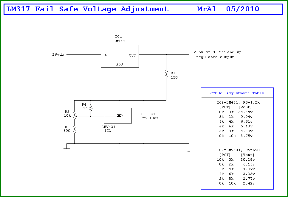

Hi again,
Since a crowbar circuit or secondary regulator would require another regulator ic, i guess it would be reasonable to allow a reference diode or three terminal shunt regulator ic to enter the picture.
See the new attached diagram (predicted voltages are approximate but should be close, and when the pot is set to 8k and 2k for example that means the top section is 8k and lower section is 2k).
This LM431/LMV431 solution seems pretty simple and fail safe, but the main problem is that it will not adjust down lower than 3.75v with the LM431 and 2.5v with the LMV431. Also, the adjustment range is spread out pretty badly over the pot rotation, in fact very nasty...which probably means a fine tune adjustment would have to be introduced too.
Any more ideas or comments welcome too.
