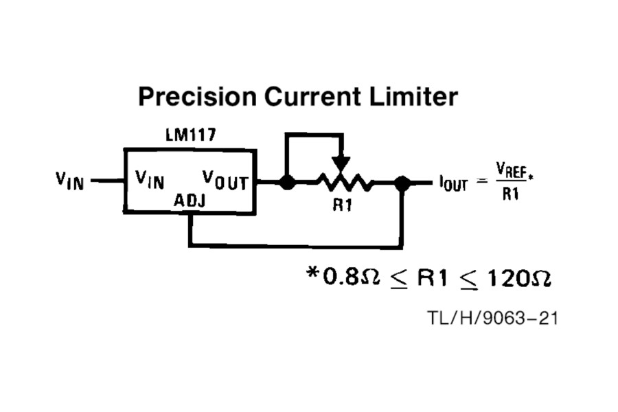

Attached is a circuit from the National data sheet. I want to drive a super-flux LED (well, 2 or 3) with a 317 wired for constant current. The data sheet was a little light on material, so hoping to see if I'm on the right track here.
The LEDs are 2.2 volts 70mA Max, amber (if anybody cares), power from NiCd battery pack, 4.8v, but can add more if needed.
They gave an equation for output current as: Iout=Vref/R1
I took Vref to mean 1.25 volts, from the beginning of the data sheet.
.07=1.25/R1 R1= about 18 ohms
Now, does mean I'll get 4.8v @ 70mA max output?
Since 2 LEDs in series will use 4.4 volts, will the remaining .4 volts be a concern?
Or do I loose 1.25 volts in the LM317, and only get 3.55 volts out?

The 317 won't give you 4.8V out if you put in 4.8V, it will drop a certain amount of voltage across the device - check the datasheet. As far as the series voltages of the LEDs are concerned, I'm not sure I understand why you are concerned aout the extra 0.4V. A constant current source's voltage is variable, but the current is constant.
If you want 4v out, give 7v in ... of course, the actual numbers vary a bit on things like current draw, but just off the cuff, I see the lm317 as "costing" 3v to operate ... since your source and load are very close in voltage, I don't see much need for an active regulator ... especially since batteries aren't known to suddenly change? a simple series resistor can eat those extra 400mV as heat, and will be more efficinet than the 317 in that case.

The datasheet for the LM317 says its input voltage needs to be 2V more than its output voltage at your low current.
Its 18 ohm resistor needs an additional 1.25V.
Your LEDs might be 2.2V at 20mA or who knows what voltage at their max current of 70mA. Maybe 3V each.
You want to operate them at their max? Do they have proper cooling?
Therefore the input to the LM317 must be a minimum of 9.25V. The circuit is constant current so additional input voltage won't change the current, it will just create more heat in the LM317.
The heat is the voltage across it times the current in it. The datasheet says that the TO-220 package will get too hot with a dissipation of only 2W without a heatsink. If your input voltage is 9.6V then the LEDs will have about 6V across them, the 18 ohms will have 1.25V across it and the LM317 will have the remainder of 2.35V. At 70mA it will dissipate only 165mW of heat.

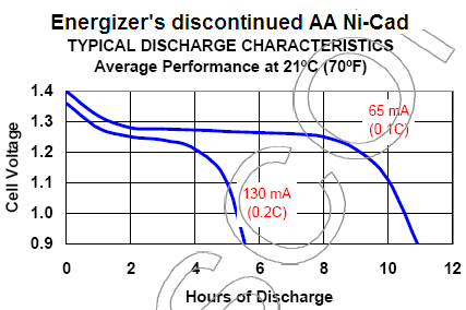

A 4-cell Ni-Cad or Ni-MH battery is not 4.8V. It is 5.6V right from the charger, 5.0V to 5.2V with only a small load current and 4.0V when it needs charging.

Thanks, could have sworn NiCds were 1.2 volts. Will make the adjustments. The batteries still have a couple hours left on the charger.
The nominal voltage is 1.2V, check my discharge graphs at to see what they actually perform like! - they are from two AA's in series feeding a small torch bulb, which is a fairly representative use.
I go to www.energizer.com for battery datasheets.
Battery cells have an internal resistance so their voltage drops as their load current is increased. At the low current for your LEDs then the average voltage is 1.3V or more per cell.
