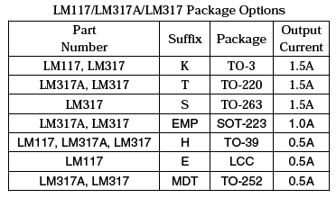

Please! correct me if I'm wrong, but I thought the LM317 had a higher amp rating than the LM117, other than that, they are the same.
Kinarfi
Off the spec sheet!

Thank you, I did some reading and saw the errors in my thinking and decided to delete, but it did appear the out put was limit by case size also, heat dissipation is suppose.

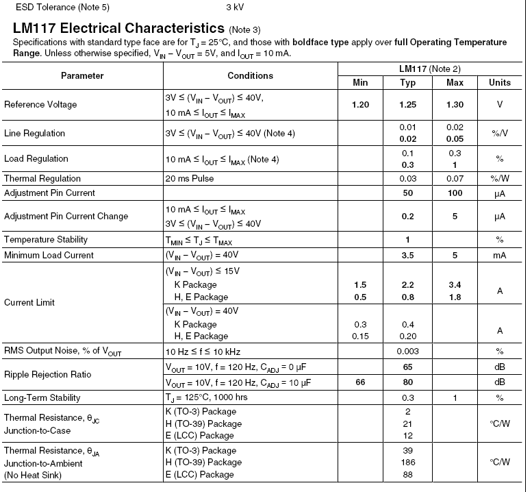

In this section:
vivo-jpg.31457
Under conditions on the second line. Does that mean if Voltage In/out is greater than or equal to 3 and less than or equal to 40.
Or does it mean If voltage in is greater than Voltage in MINUS Voltage out.
Is that a minus sign or a dash.
The spec lists the voltage across the regulator from its input to its output. It is from 3V to 40V.

To amplify on audioguru's comment, it's a minus sign, thus it's the input voltage minus the output voltage.
So does that mean you could put 50V into it and have 30V Output? Because 50 - 30 is 20 which is under the 40V they have listed.
The LM317 does not have a ground connection.
If you limit the voltage between its input and output to 40V then its input could be 50V and its output could be 10V to 47V.

So the "conditions" sections of a datasheet are just the test conditions at which they get the result numbers. I assume though that the test's numbers that are posted are usually done at the minimum and maximum specs of the chip?
Yes, the test numbers posted in the datasheet are usually the guaranteed minimum and maximum spec's. The "typical" is also posted and most graphs show the typical numbers.
