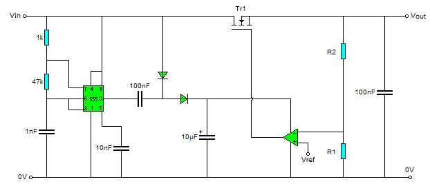

This will give a dropput in the 50mV range (even less if you use a good enough MOSFET), so it will work even if your battery drops to 6V.
Neat idea. Shouldn't the MOSFET be pointing the other way (source to output)? Also, I believe a logic-level MOSFET and a rail-to-rail op amp would be needed for operation down to 6 volts. The voltage doubler will only yield about (6+ 6-1.4)=10.6V, which is the maximum gate voltage, even with a rail-to-rail op amp.
A P-channel MOSFET would eliminate the need for the 555 voltage doubler. You would have to reverse the op amp inputs, and provide frequency compensation to prevent oscillations. This might not be practical. I haven't tried it.
I was adapted from a circuit which used a p-channel MOSFET but I'd forgotten to swap the source and drain which I've now rectified. An n-channel MOSFET would be better as it would give a lower dropout because the on resistance is lower. You could maximise the voltage doubler output by using a 7555/TS555 and schottky diodes or use a specialised charge pump IC.
there's no need for a better charge pump - a typical 30V N-Channel FET will be fully ON at 4.5Vgs. It will have a slightly lower Rds(on) at 10Vgs but not so much better to justify the extra overhead of a more complex charge pump.
