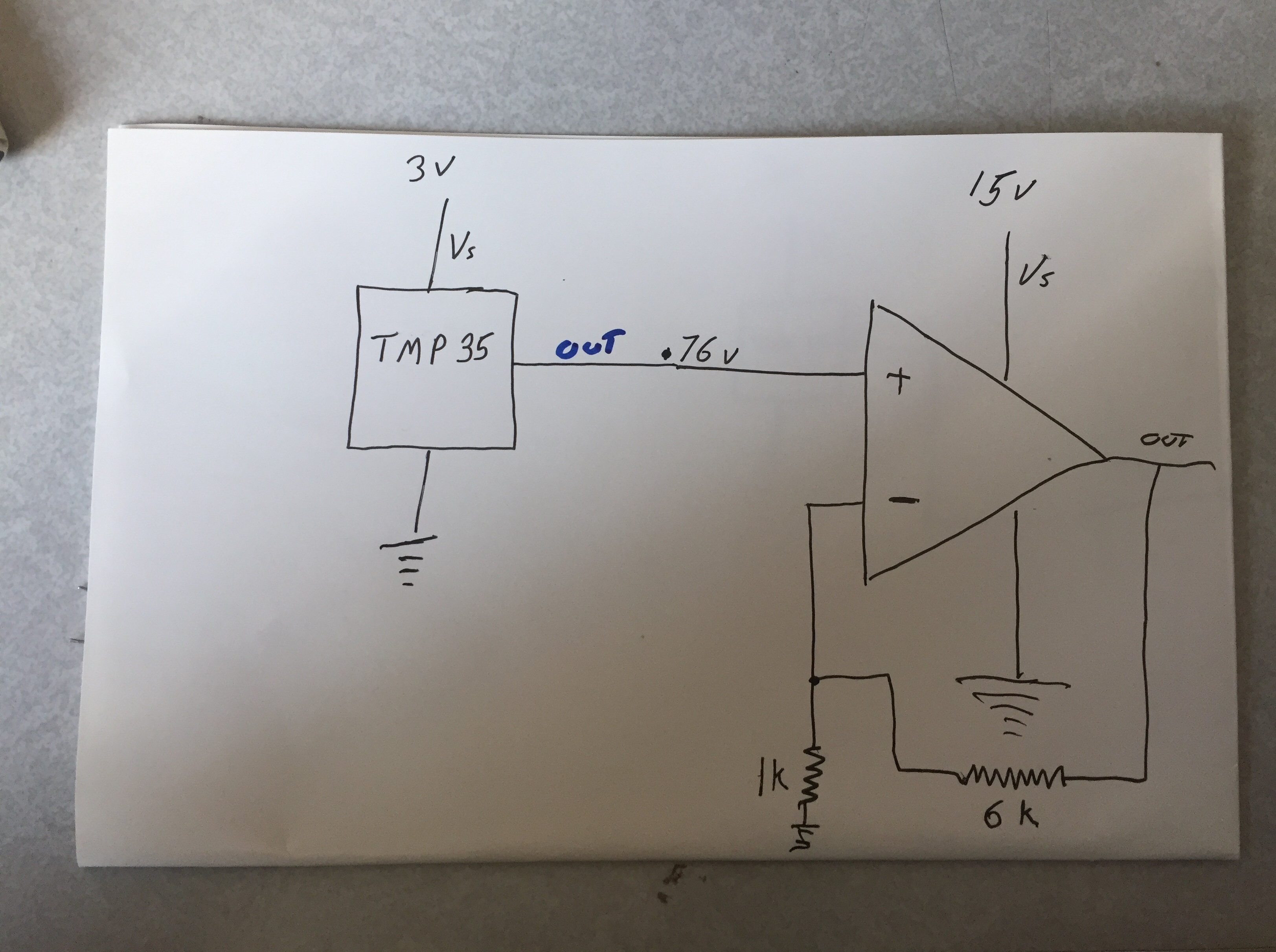

Hello,
I want to use an analog temp sensor like the TMP36 and interface it with a 0-10V card on a PLC. I just happened to have a TMP36 laying around so I mocked it up and am getting ~.7 volts from it at the target temp (basically room temp).
I'd like to raise the voltage in a linear fashion to something more workable. I tried to use a LM318 (again, had it laying around) and hooked it up as shown in my attached schematic.
I cannot get an output of any kind from the op-amp. I have my .7 going in and nothing coming out. I have tried several ICs trying to rule out having a bad one. I've never used an op-amp before so I may very well be missing something basic.
I've studied AudioGuru's circuit (https://www.electro-tech-online.com/attachments/opamps-gif.16569/) and mine matches his non-inverting single supply circuit minus the voltage divider.
Anyone have any suggestions?

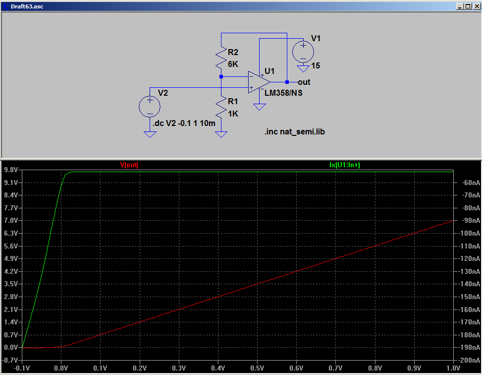

For a single-polarity supply, as you have, the LM318 cannot operate properly with an input voltage less than about 3.5V, according to its datasheet.

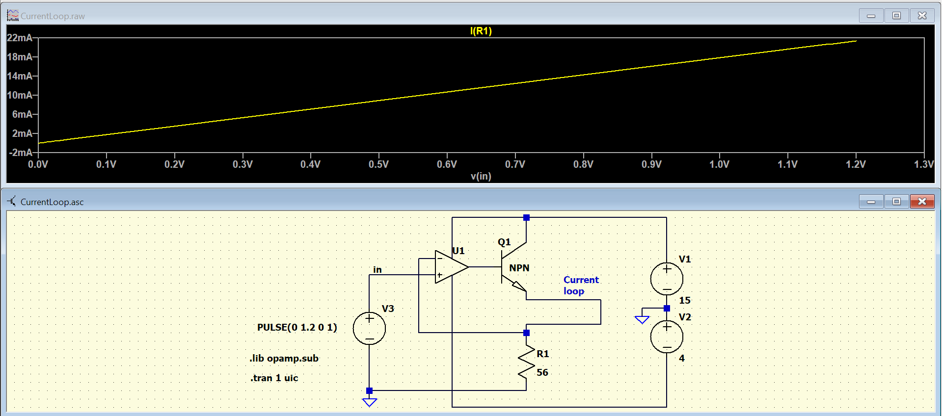

Also, if anyone is so inclined - if I wanted to translate the .7 volts into a 4-20 mA signal - would that be exceedingly complicated? I don't know that I want to, but I have been pondering it in my head.
The LM318 is a very old design, and is not rail-to-rail in or out. Even the crummy old LM324 or LM358 would work in your application because it's common-mode input voltage range goes down to -0.5V with respect to the V- pin.
There are now hundreds of opamps that are rail-to-rail in and out

0.7v would ideally be about 12mA or something. Mostly I am just wondering where I would start if I wanted to play with that route.

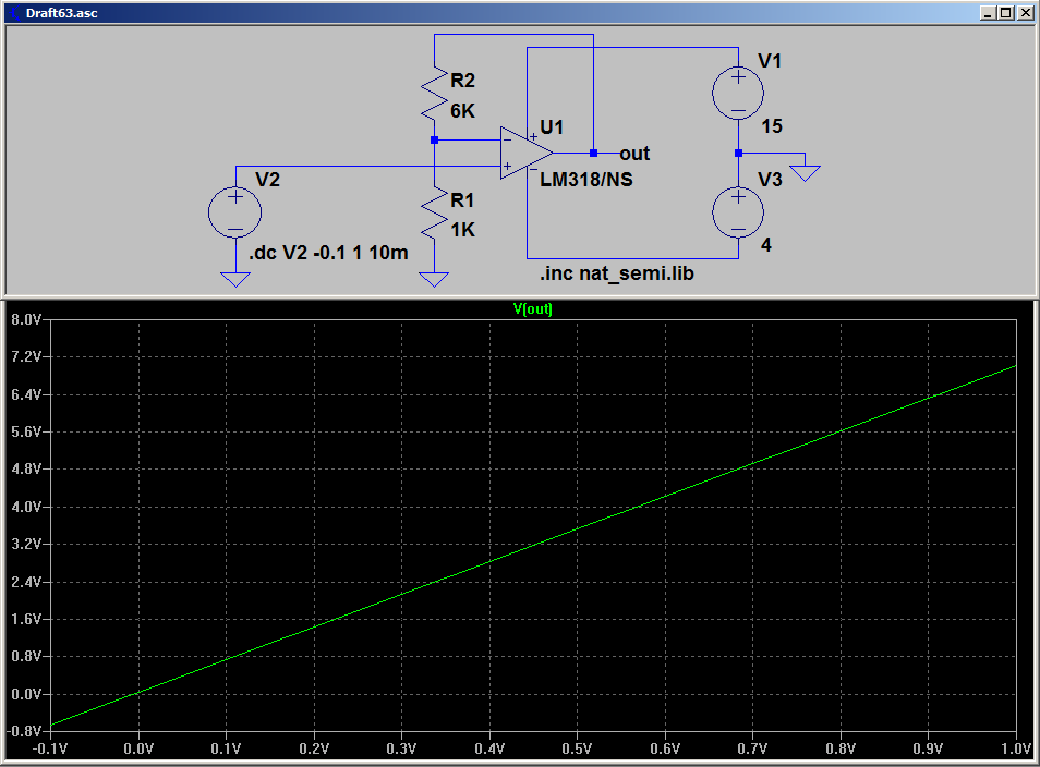

To make that circuit work with the '318, you would have to add a negative supply of at least 4V. This makes for split supplies, +15 and -4V.
Thank you Mike. I clearly need to study how op-amps work :)
