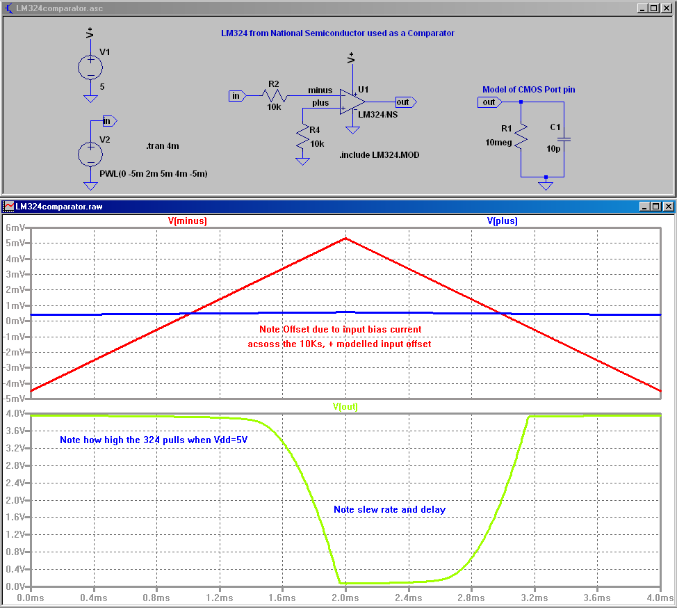

I am using a lm324 voltage compatitor for a project of mine.
The output of the comparitor is to be connected to a microcontroller.
Is it connected like this:
Note the non-ideal behavior. It works with one input at ground, but it is slow and it has some offset. The common-mode range includes ground at the bottom end, but only goes to about +3V when operated on single 5V supply.
its the same except for the ground to which i connected a reference voltage
What is the reference voltage? What is the supply voltage?
