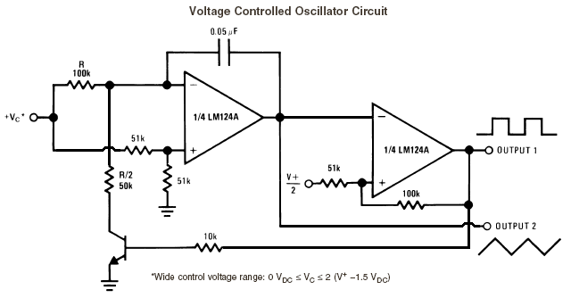

I once had a diagram to built a Voltage Control Oscillator out of a LM324. I dont found it anywhere. I try to google without luck. Anyone got a LM324 VCO circuit and shared it ? Thanks. I will like to built a small synth (music instrument) using such oscillator.
The VCO schematic is on page 13 of the datasheet for the LM324. It uses only 2 of the 4 opamps so an LM358 dual opamp should be used.
Circuit is wrong
The VCO circuit on page 13 of the LM324 app note has an error.
It shows a wire from the last stage's output to the inverting input.
Remove that wire and the circuit will work.
Look again. That wire's not connected that way. It's a separate output.
It doesn't have the wire.

Looks like they caught the error and corrected it. My printed 1995 databook has the bogus extra connection.

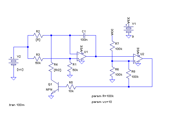

Who did know the way to count the output frequence of the VCO?Can whom Know that show us a expression? f=?
My translation of this is, "Who knows how to calculate the output frequency of the VCO?":)
If you make several simplifying assumptions:
1. The comparator op amp (the one on the right) has rail-to-rail output,
2. Vce(sat) of the transistor is zero volts,
3. the transistor has zero storage time,
4. the comparator op amp has zero recovery time from saturation,
then the frequency is
F = 3*Vc/(4*Vcc*R*C) .
This is pretty accurate for low frequencies and high control voltages. For high frequencies, the recovery and storage times become significant. For low control voltages, the Vce(sat) becomes significant. What is considered significant is up to the user.;)
An LM324 does not have rail-to-rail output. If you use it, the equation could still be calculated, but it would be even more approximate than the one above.
